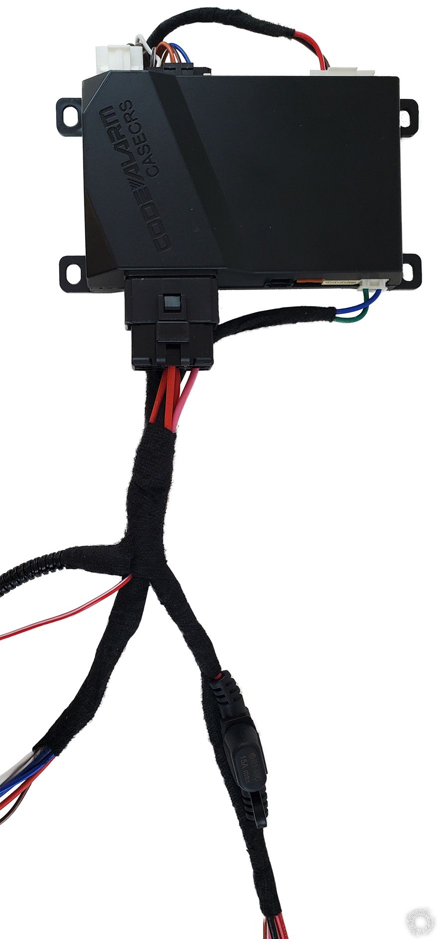

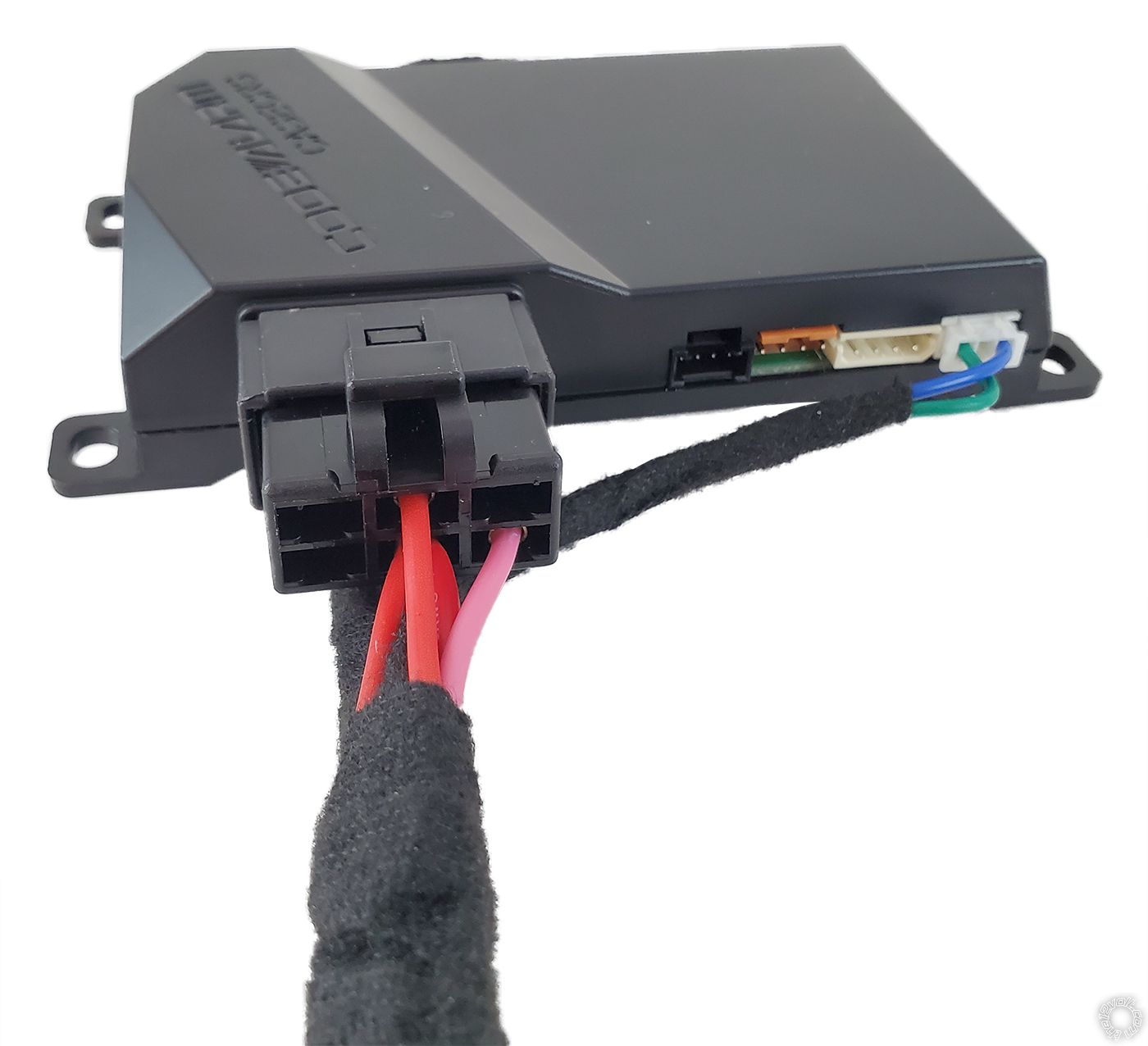

Personally, I always remove extra/unused wires. I place them into a bag and throw the bag and manual in the glovebox.
If the vehicle has smaller gauge wires for remote start, then I will usually re-pin the main module harness as well. Helps clean up the install and I am not stuck trying to solder 12 gauge module wires to 18/20 gauge vehicle wires.
I have attached two photos for reference

I am personally not a fan of PIN Pulling.. I would rather cut the wire short, and leave it there, in case I need it.
