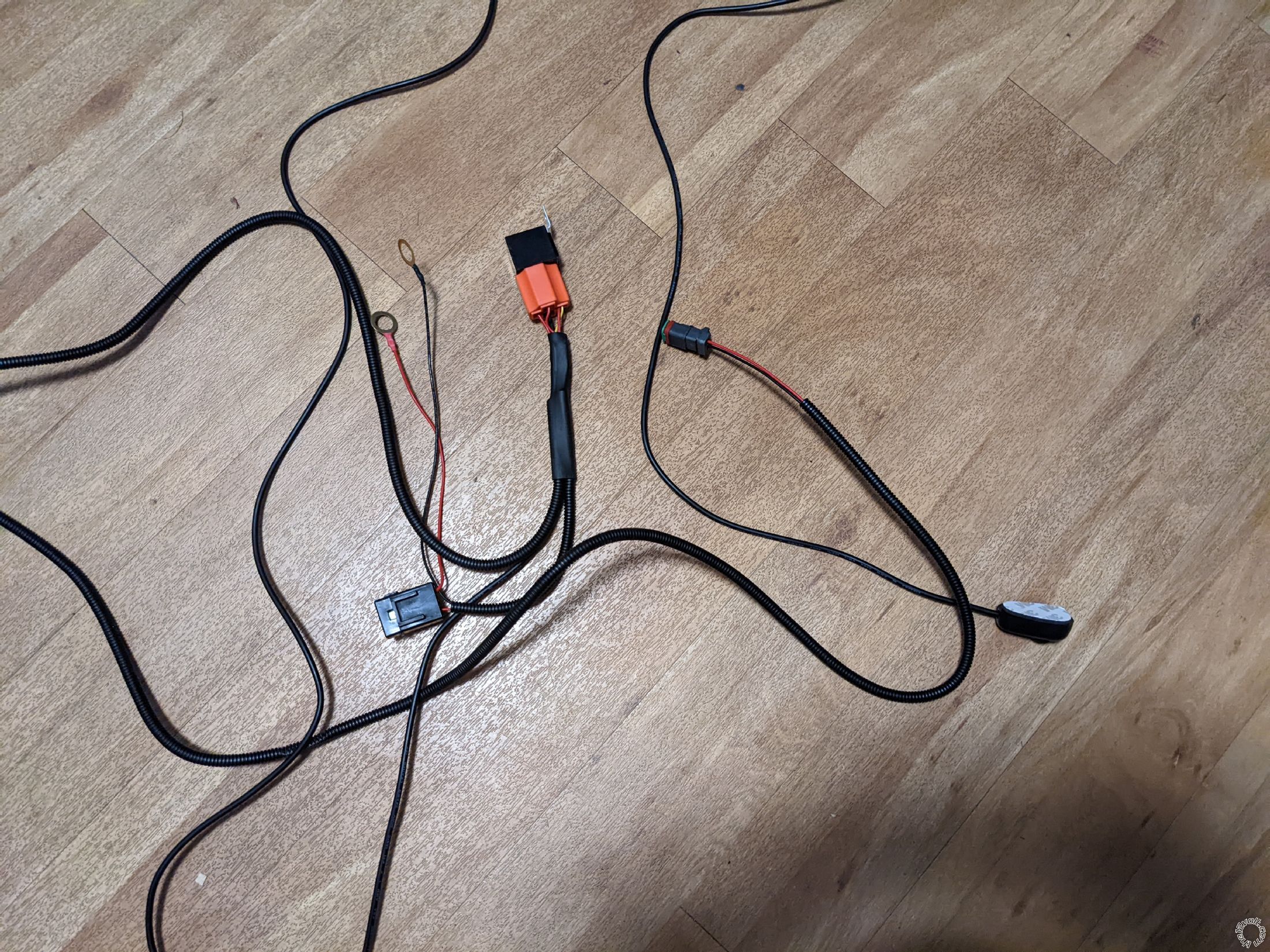

i bought a light bar wiring loom kit , but it doesnt have a activation wire to trigger the relay so the bar comes on and off with the high beam. its either on or off. see pic
there is a red , black and yellow wires coming of the on/off switch. LED Lightbar Wiring Loom, No Activation Wire -- posted image.
any one help me how to modify this to work with high beam activation wire ?

Take the red from the switch and take it directly to the +12v high beam trigger, cut it from the rest of the harness though.
