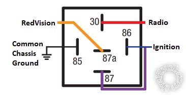

Looking to be able to control a device through either an ignition or a on demand distribution device (RedArc Redvision). IE it’s a midland gmrs radio max 5amp. That will be mounted in the cab of the vehicle with a microphone/controller 12v ignition and have a second microphone/controller mounted in the camper portion of the vehicle 12v Distribution Box (Redvision). Here is what I was thinking. Will I run into any issues. Been over a decade since I’ve done anything like this.
Dual Or 12V Input, Single Output Relay -- posted image.

Posted: June 13, 2022 at 1:30 PM / IP Logged Link to Post Post Reply Quote i am an idiot
That will work just as you need it to.
