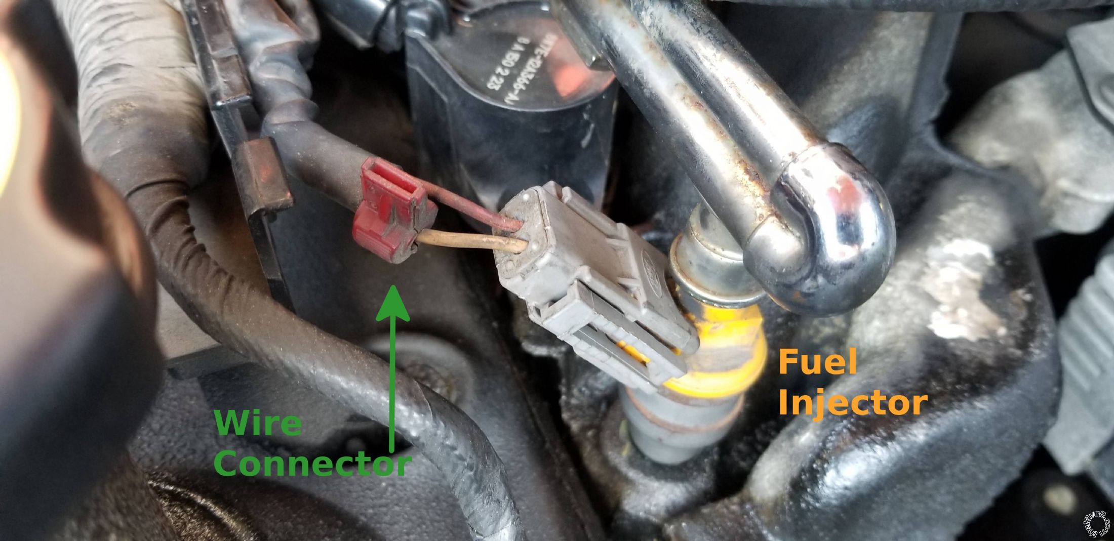

2) I've been reading the documentation that I can get my hands on related to this unit. I found the docs for Python 1500ESP and for the "553A" (instead of mine, which is 553P). Those mention a "tach" wire that can be tied into a non-red wire on a fuel injector. I looked and found a (dunno the correct name) wire connector attachment on the non-red wire of the fuel injector for cylinder #1 (which is the easiest to reach). There is no wire connected to the little add-on wire connector, however. I looked for a wire that seemed loose hanging around somewhere that looks like maybe it belonged there, but I don't see one that stands out to me. I don't know for sure that my unit ever had that wire connected, but why else would there be an add on wire splice connector on that one fuel injector? Would that wire being mistakenly disconnected maybe cause the behavior it's exhibiting (starting with hood open, but not when hood is closed)?

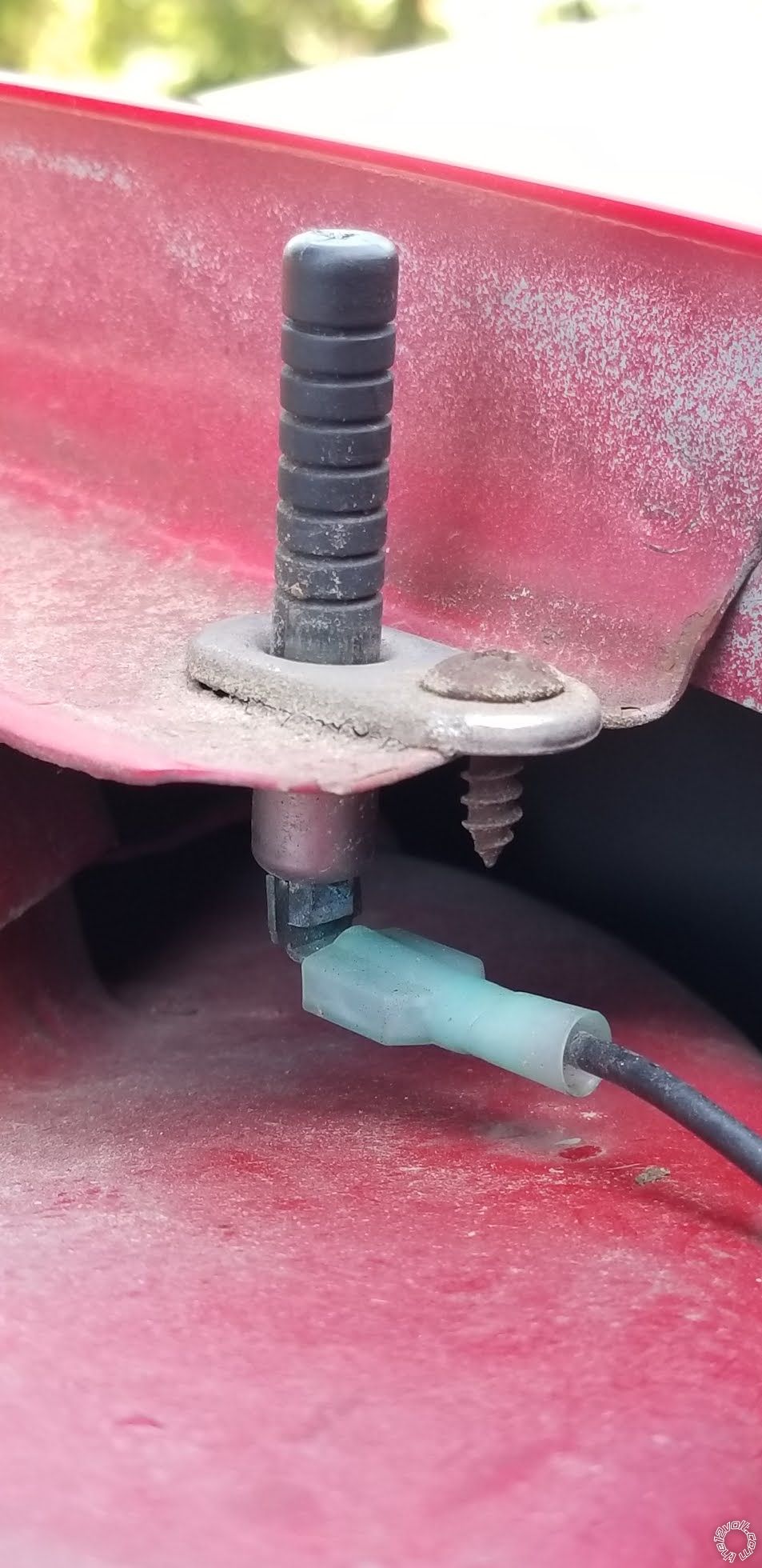

I investigated some more. I discovered that the hood is not contacting the hood switch at all, therefore not depressing it when closed. There is a worn spot in the paint under the hood where the hood switch has contacted for 20 years, but now it doesn't even touch. I retested the remote start while holding the hood switch down with my finger--it worked. I armed it while holding the hood switch down with my finger--it armed with only one chirp, not the extra one that indicates active input from a zone. So, my conclusion is that there must have been another "bumper" portion that sat over the black plastic post of the hood switch that is visible now, raising the height of the switch to contact the hood. It must have come off, maybe during the mechanic's crawling around the area to replace the injectors. Of course with the hood switch being in the grounded "up" position, the remote start unit thought the hood was up and wouldn't start. Also, the security module thought the hood was up when I armed it, therefore chirping an extra time to indicate that. I can't explain why yesterday it remotely started when the hood was up and the switch wasn't depressed, unless the switch just happened to be in a bind and still a little depressed, but today it rightly did not start when I tried to remotely start it with the hood up.
So, I either need to make a little topper for the hood switch post that will increase its height and cause it to be depressed when the hood is closed, or I could just buy a new hood switch. I don't know which I'll do, but I'm usually inclined to repair rather than replace.

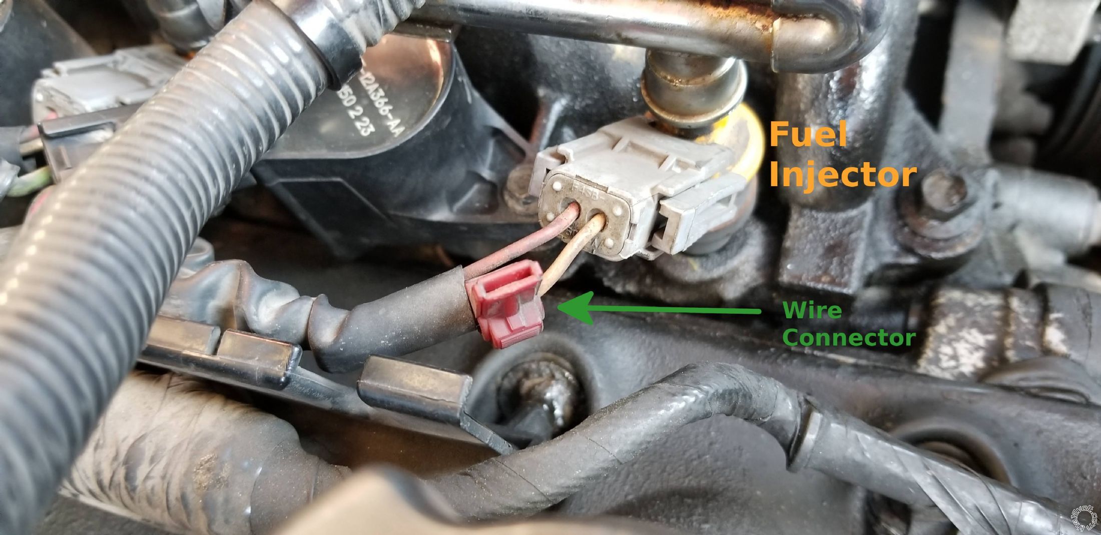

This still leaves me with curiosity about the wire connector that I found on one of the fuel injectors, shown in photos. I looked but could not see any stray wire that seemed like it was once connected to this connector, but what other possible reason would there be for this connector to be on the yellow wire of this one fuel injector? I'm the only owner of this vehicle since it was new, and I had the security/start module added aftermarket right after purchasing the truck. What are the implications/consequences if there was a "tach" wire connected here at one point in the past, but it is no longer connected?

mj7229
Joined: February 27, 2004
Posted: September 01, 2022 at 1:37 PM / IP Logged Link to Post Post Reply Quote mj7229
Nice find!
You could unplug the hood pin switch temporarily to allow the remote start to work while you come up with a solution.
Just be aware that it would allow the engine to start with the hood open.
The wiretap on the fuel injector wire might be there if it didn’t work correctly during the installation and the installer needed to get a tach signal somewhere else.
I’ll bet he just left the wiretap there instead of removing it.
DEI used to use a violet wire with a white stripe for the tach wire when I was an installer in the 90’s.
You could see if there is one going somewhere else in the engine compartment.
It is a pretty thin wire, maybe 20 or 22 gauge.
The system uses the tach wire to recognize when the engine has started, some systems will also use it to shut the remote start down if the engine starts over revving.
Many newer remote start units don’t use a tach wire at all, they monitor the voltage fluctuation while the engine is running.
