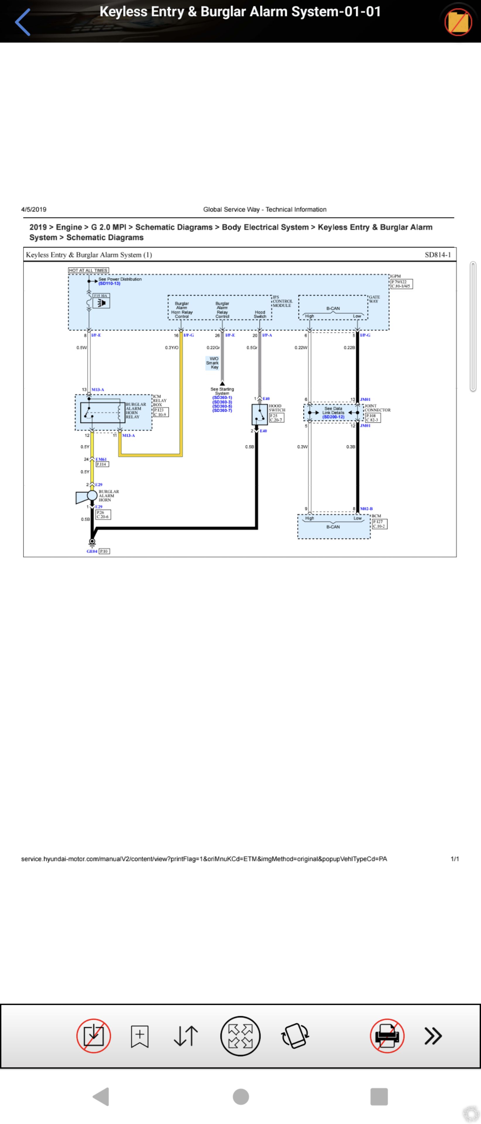

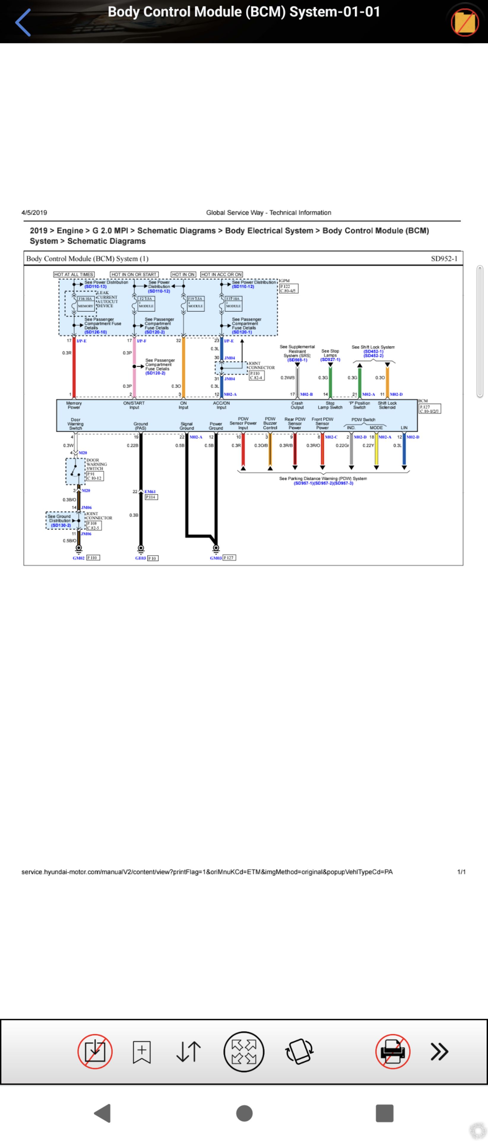

Do you also have the wiring diagram for a 2019 Hyundai Kona? Particularly interested in the wiring color for the door and hood switches. Thanks

2019 Kia Sorento, Locating Door Switch Wire For Shock Sensor Install -- posted image.
