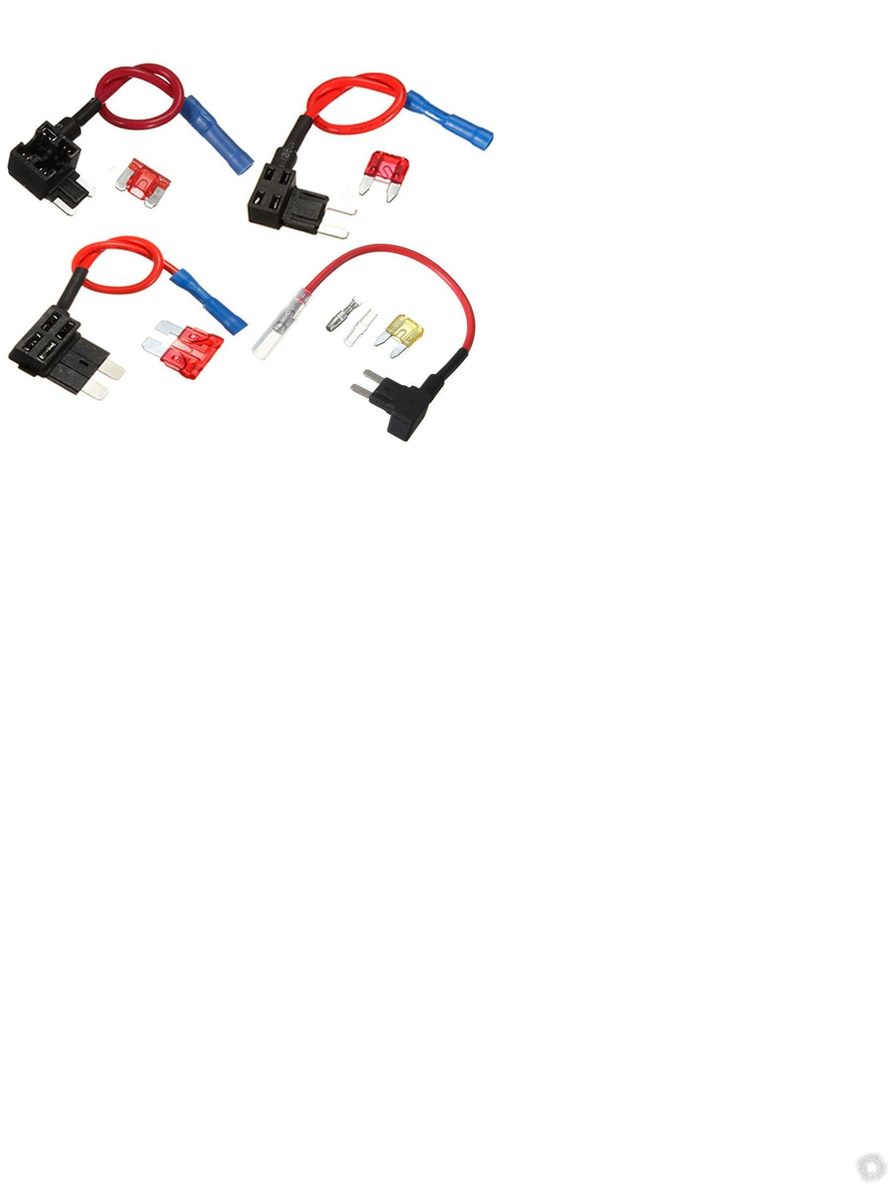

One possible way to do this is to check the fuse box for a fuse that has no power when the CR-V is off and then gets power when the CR-V is running under remote start. There should be a few that exhibit this. Then you could use an "add a fuse"* circuit to power your low current draw LED indicator(s). The only issue is that the LED will probably still be on during normal vehicle operation. You could add a switch to the LED circuit to be able to turn them off when desired.
*2018 Honda CR-V, Remote Start Aux Connection? -- posted image.
