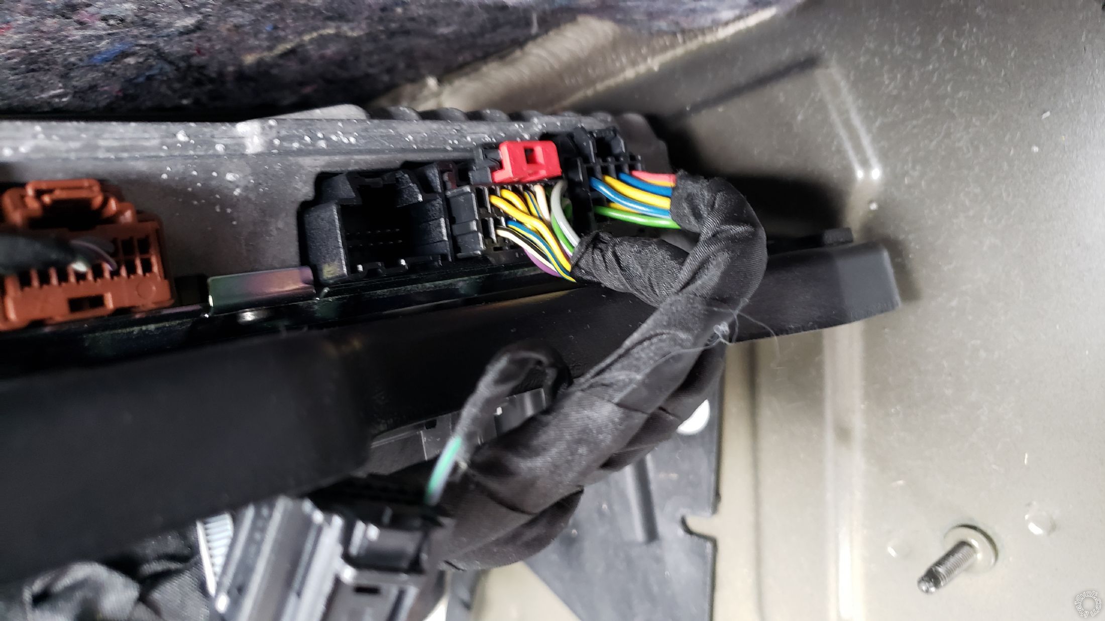

Hello all was looking to add subs to my bose system...I have the bose amp with 3 black 1 brown connectors...I intend to use the kicker kisloc or kisloc2 depending on if I can get remote turn on from factory amp or not...any chance on schematic for x1 x2 x3 also I know I need to bypass the anc just really need schematic... 2020 Chevrolet Impala Premier, Bose Amp Leadouts, ANC Bypass -- posted image.

looks like x1-
microphone ref
gry/brn pin 14
blu/blk pin 13
grn/blk pin 12
microphone sig
gry/blu pin 6
blu/yel pin 5
grm/brn pin 4
remote turn is controlled by data from deck, no wire. could always use a audio control lc1i for loc and a remote turn on output
right rear door is grn/blk is negative green is positive

Thanks for response, any help is good atm ...I understand remote from head unit...just don't know which wire it is at the back on passenger side on amp inputs to splice signal to power amp for subs...if thats where ...more importantly I need the signal lines for sub so im looking for left and right rear low output lines from head unit
