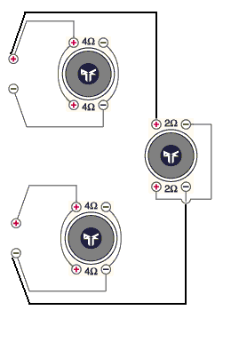

I don't know if DHD amps are capabile of handling "Tri-Mode" or not, so use this portion at your own risk (I'm also not sure what the power distribution would be in Tri-Mode). Tri-Mode can work, but only on amps whose circuitry was designed to handle it...
To wire Tri-Mode, you would need two 4ohm DVC's and one 2ohm DVC.
The two 4ohm DVC's would each be wired in Parallel (1 sub per channel). The one 2ohm DVC would be wired in Series and Bridged. It would look something like this...
Subwoofer suggestion -- posted image.
