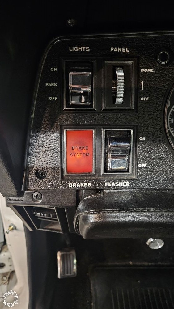

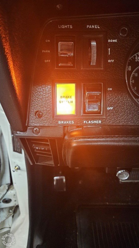

69 Charger with an Avital 5303 alarm and remote start. The brake warning light comes on bright when the parking brake is set, but when I turn the parking brake off, the warning light stays dimly lit instead of turning off. I have the brown wire H3/3 hooked to the brake switch. The remote start works fine. Am I getting some power fed back to the light? Do I need a diode somewhere?

No, the light stays on with the brown wire disconnected. Depressing the brake pedal also has no affect on it. As soon as I turn on the ignition, the bulb lights up a bit. Weird.

With the brown wire disconnected and you are still having light issues, then it is a vehicle issue.
I'm not familiar with the wiring on a Charger but if it's anything like the Chevrolet's from that era, the brake light system indicator light should only come on when the ignition switch is in the run position and then if either the emergency brake pedal inside is depressed or the switch under the hood on the proportioning valve is not centered.
If your indicator light has an ignition 12V power going to it and then the ground gets split to go to the underdash emergency brake mechanism switch and then also to the underhood proportioning valve, disconnect one or the other but not both and see if the light then goes off all the way.
When the underdash emergency brake is set, the light comes on bright so with the emergency brake inside the car not engaged or on I wonder if the secondary switch on the proportioning valve is creating a ground but not a good one that has a high resistance and allows the light to be dim but not bright ?.
