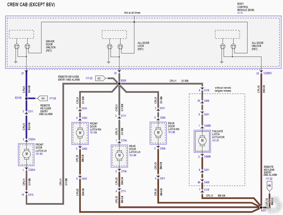

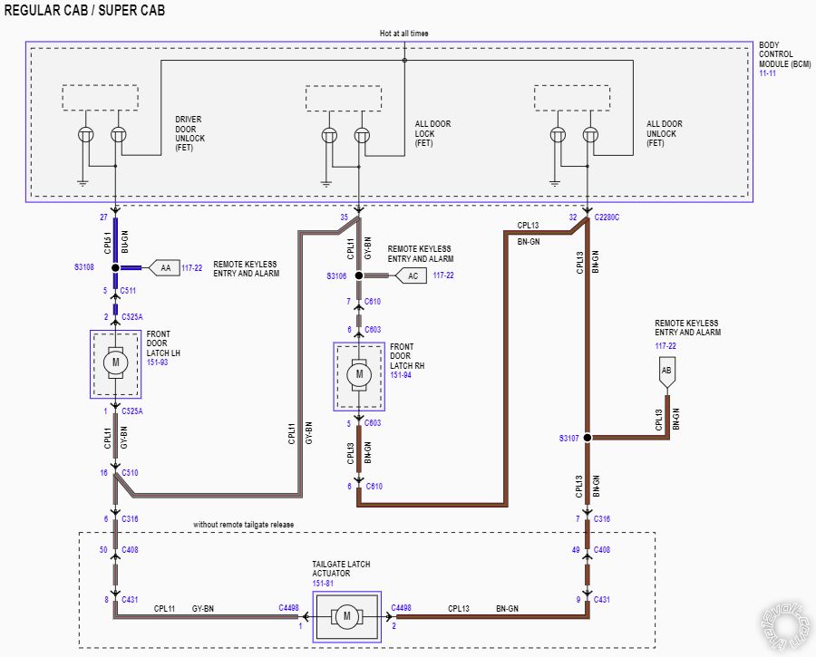

Does anyone have any wiring info for the 2023 F150, specifically the central door locking and unlocking wire locations? Or can someone verify if the 2023 is the same as the 2021 F150?

Wiring is the same from 2021-2023.
Note: BEV is Electric instead of ICE
2023 Ford F-150, Door Lock Wiring -- posted image.
