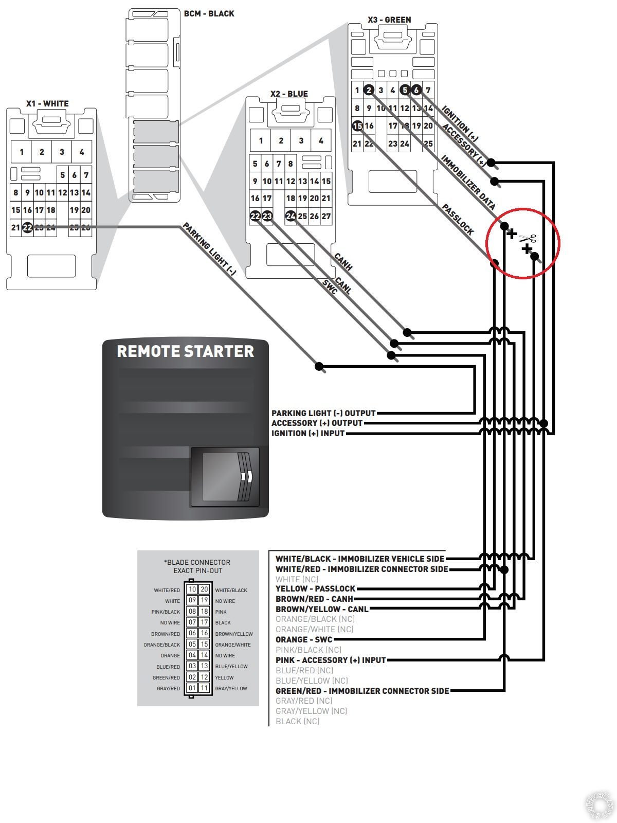

Did you do the install yourself? Wondering how familiar you are with the system. Below is a current diagram of the Blade AL install for your vehicle :
2015 GMC Terrain, Compustar CM-900AS -- posted image.
To test to see if the R/S system is causing the issue you could pull the two fuses, unplug the black 20 pin Blade harness and reconnect the one cut vehicle wire ( circled in red ).

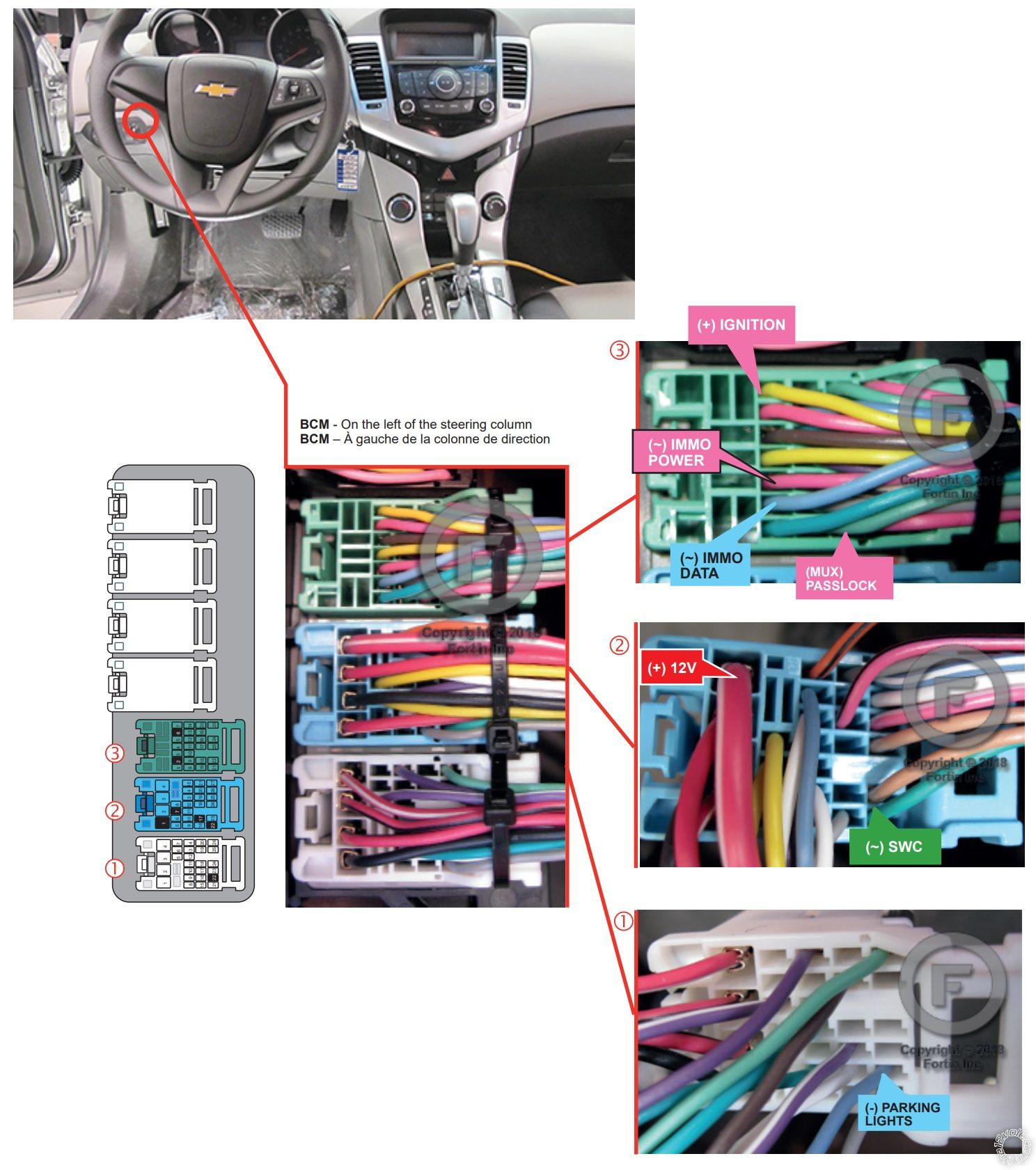

While the wiring is not exactly the same, below is a diagram of the vehicle and BCM location with its necessary connectors indicated.   Use as a quick reference.
