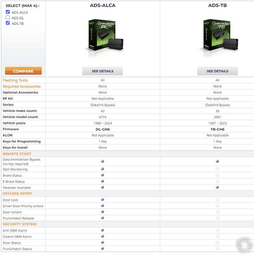

Im wondering what the difference in the two blades are. I've used the Blade AL on my 2004 Grand Cherokee with no issues and I've also used the Blade TB on my 2008 Toyota Prius with push button start. Im about to do my 2003 Grand Cherokee and Amazon has both but there's a $20 dollar price difference with the Blade AL being $80 vs the Blade TB being $50. What's the difference?

TB is usually only for Transponder Bypass. AL will support other features that are on the data bus.
This is a module comparison specifically for a 2003 Jeep Grand Cherokee.
Blade AL vs Blade TB? -- posted image.
