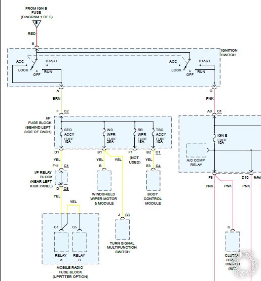

Thanks. The only thing I was worried about was the BCM power that it shows pulls from it. 2005 Chevrolet Silverado, Avital 5105L Remote Start, GMDLBP -- posted image.

I'm just guessing with regards to the Silverado (because I don't work on the Trucks), but in many GM of the era the BCM controls the Delayed Accessory Buss Relay. This buss powers the Radio and Power Windows. The input brown wire input to the BCM is for the DAB control. Even if it is used for other BCM functions, it probably doesn't matter in an unoccupied vehicle.
I'd try it first without powering the Brown wire. It will probably work as expected.
