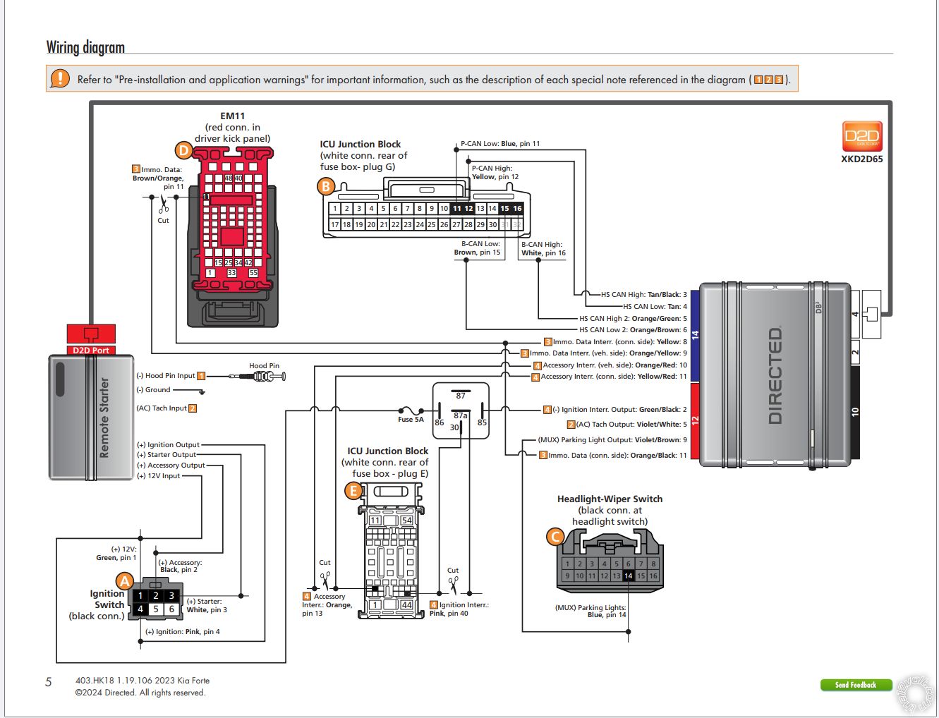

2023 Kia Forte LXS, Viper 5706V Alarm/Remote Start -- posted image.

Thank you. I found an installer near me who is going to program the module for me. So just to clarify... the DB3 says it includes the locks and factory alarm and all that. So I do not need to connect anything from the lock wires on the remote start to anything? These are the only connections I need to make?

the db3 will do everything through the data wires. just follow what the install sheet says and as long as the module is programmed, you should be good to go.
