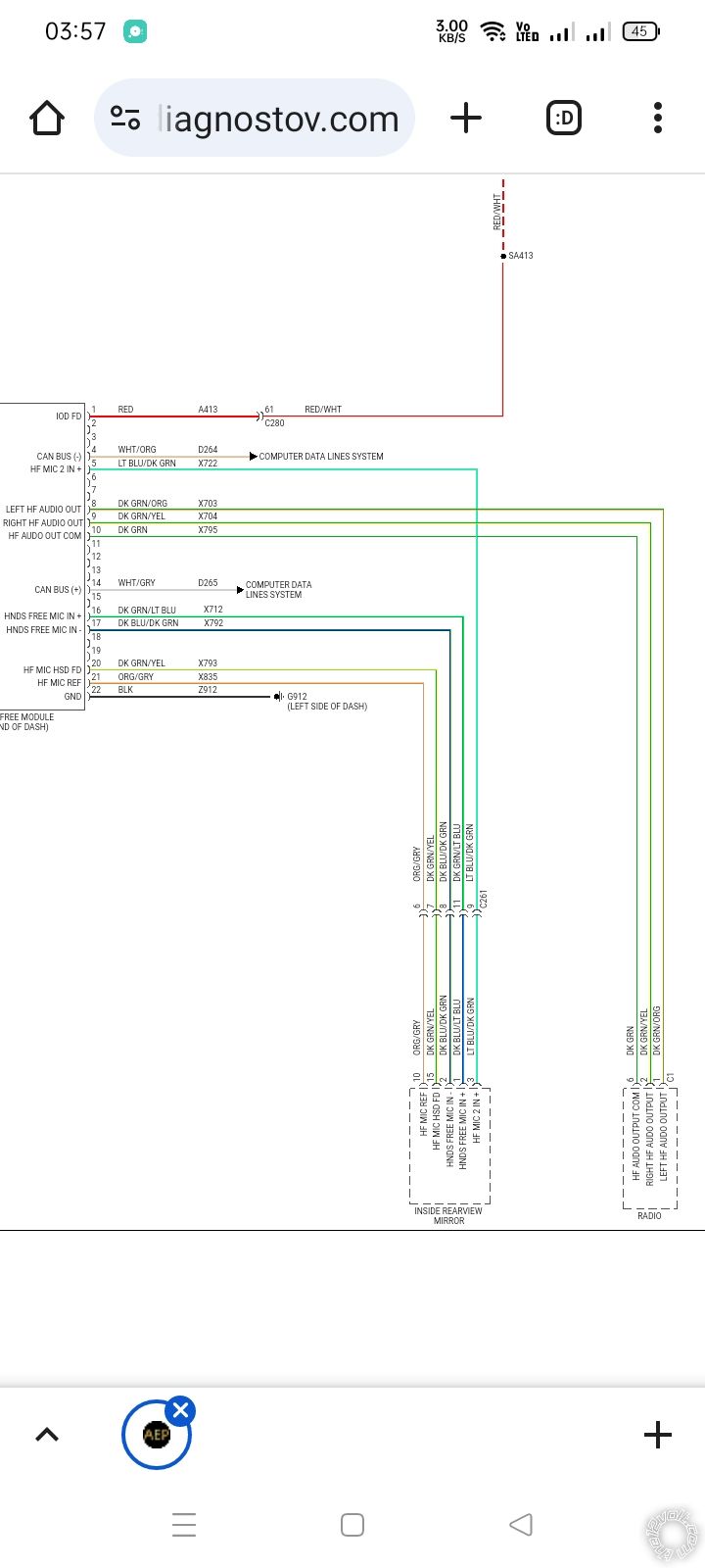

Posted: December 18, 2024 at 8:06 PM / IP Logged Link to Post Post Reply Quote meccano
Did you make it ?
Found something good ,
The microphones are connected to the Bluetooth module down on the left side of the steering wheel.
Please let me know if you van make it!
2014 WK2 Jeep Grand Cherokee, Built In Microphone Wiring -- posted image.
