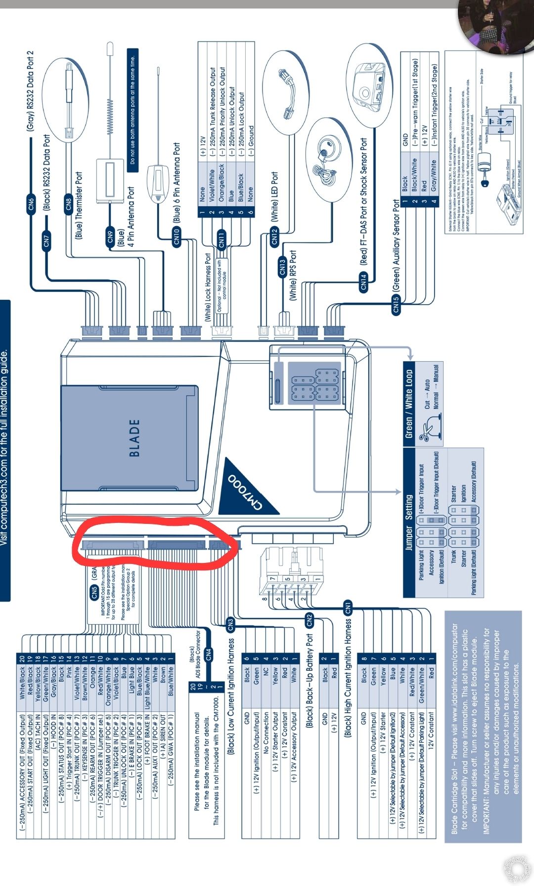

Ok I have just had a quick look under the dash again and it seems that it has the cn5 cn4 and cn3 harnesses installed, however I am unsure where all the wires go without pulling apart the dash to chase them.
It does NOT have the high voltage harness installed.
Image attached below for reference to the cn 7000 wiring diagram I found
