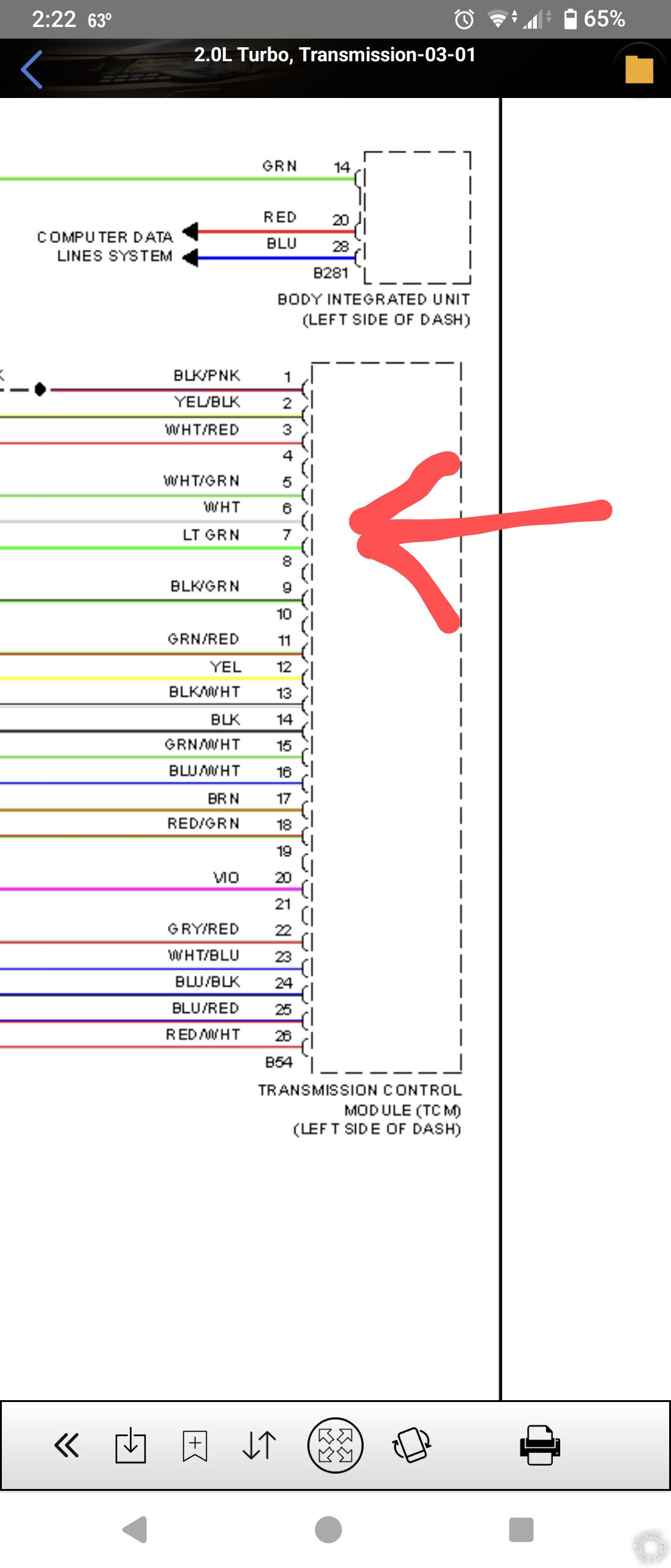

Check for a white wire at pin 6 at the TCM.
VSS, 2015 Subaru Forester, Non-Push Start -- posted image.

Thanks. I do have the same diagram but there is no white wire on that connector on this model.

The light green wire next to it at pin 7 is listed as secondary speed wire. If you don't have that you could go to a wheel speed sensor or use a universal sensor.
