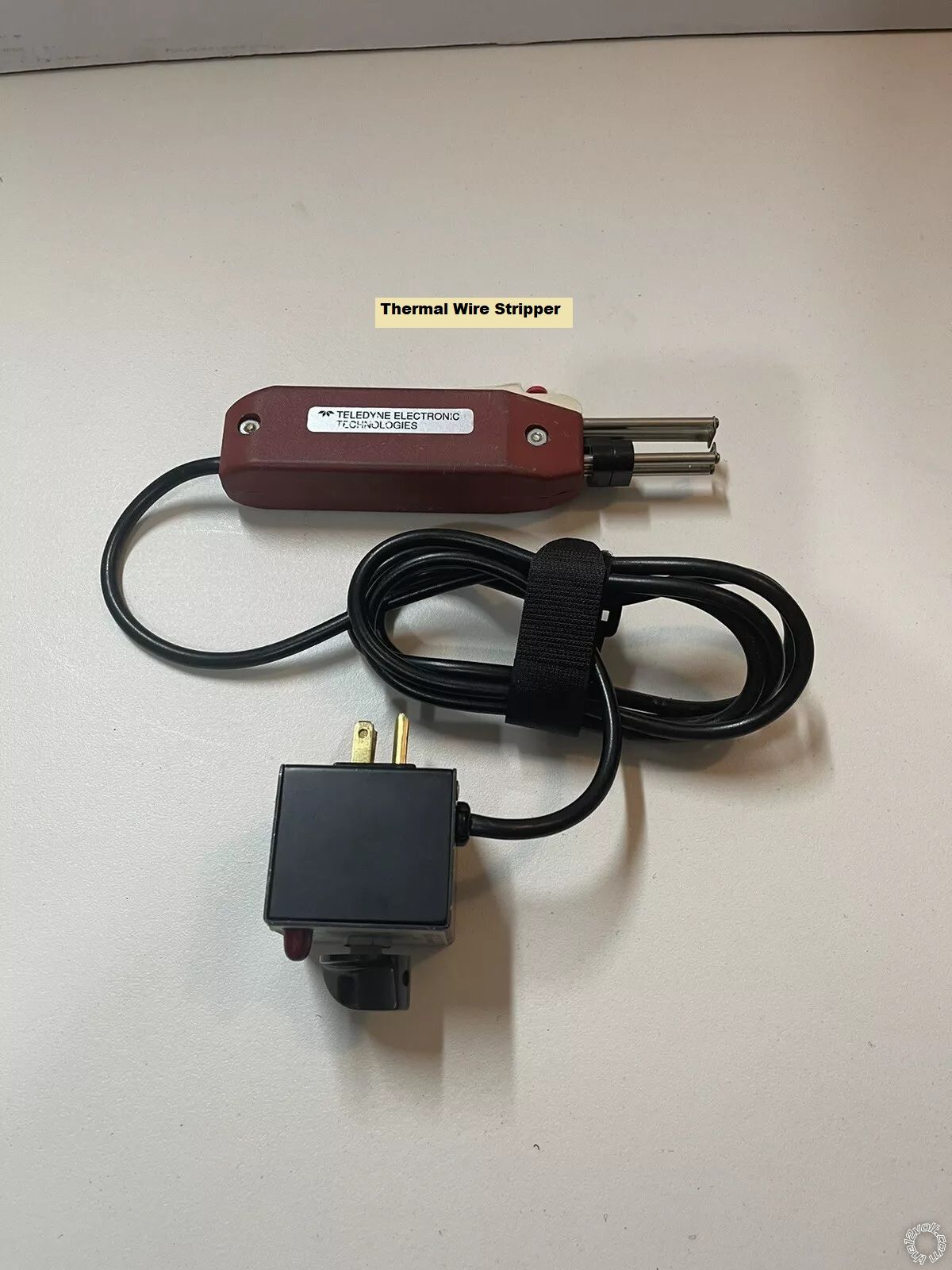

This install is a bit tedious due to the location of the BCM above the Drivers Kick Panel. No trim needs to be removed but BCM connector cable length is limited. I still refuse to use T-Taps so all wire connections are soldered and taped. Wire stripping would be a painful chore without a thermal wire stripper. Teledyne STRIPALL TWC-1 Thermal Wire Stripper shown below. Not cheap but a great tool, especially with the very thin gauge wires on newer cars (Toyota/Lexus, etc).

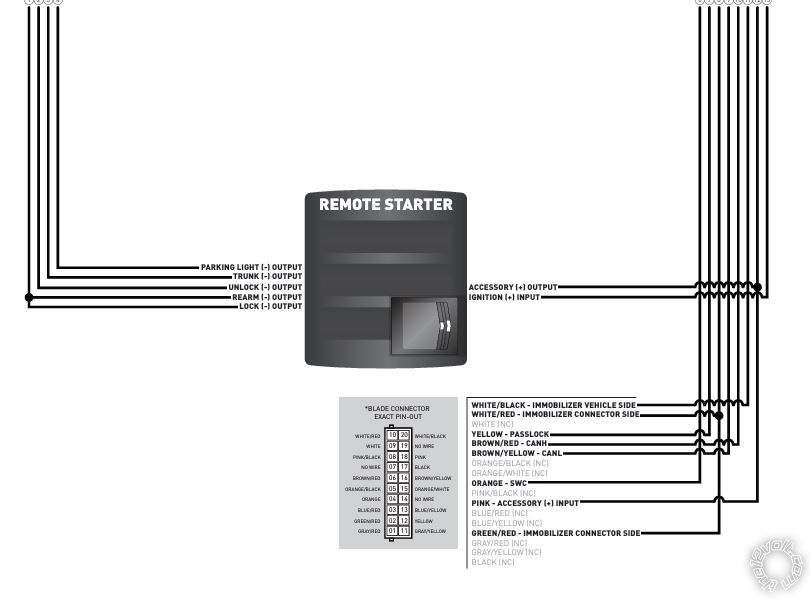

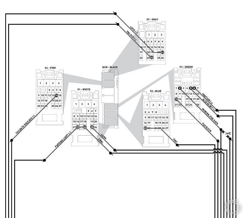

iDatalink install guide #84492 was followed for the Blade GM-12 wiring. This truck without ON-Star and no Factory Alarm system used the Type 13 diagrams. There are a total of 14 wire connections needed at 5 of the 7 BCM plugs. Blade install diagrams below :
2021 Chevrolet Silverado 3500HD, Remote Start Install Pictorial -- posted image.

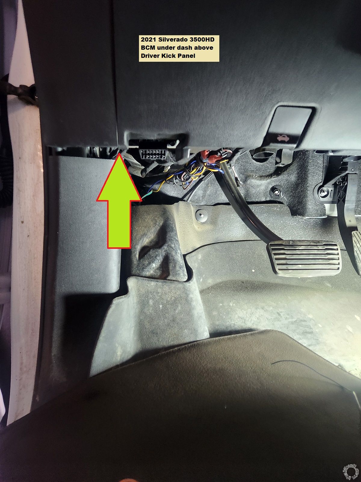

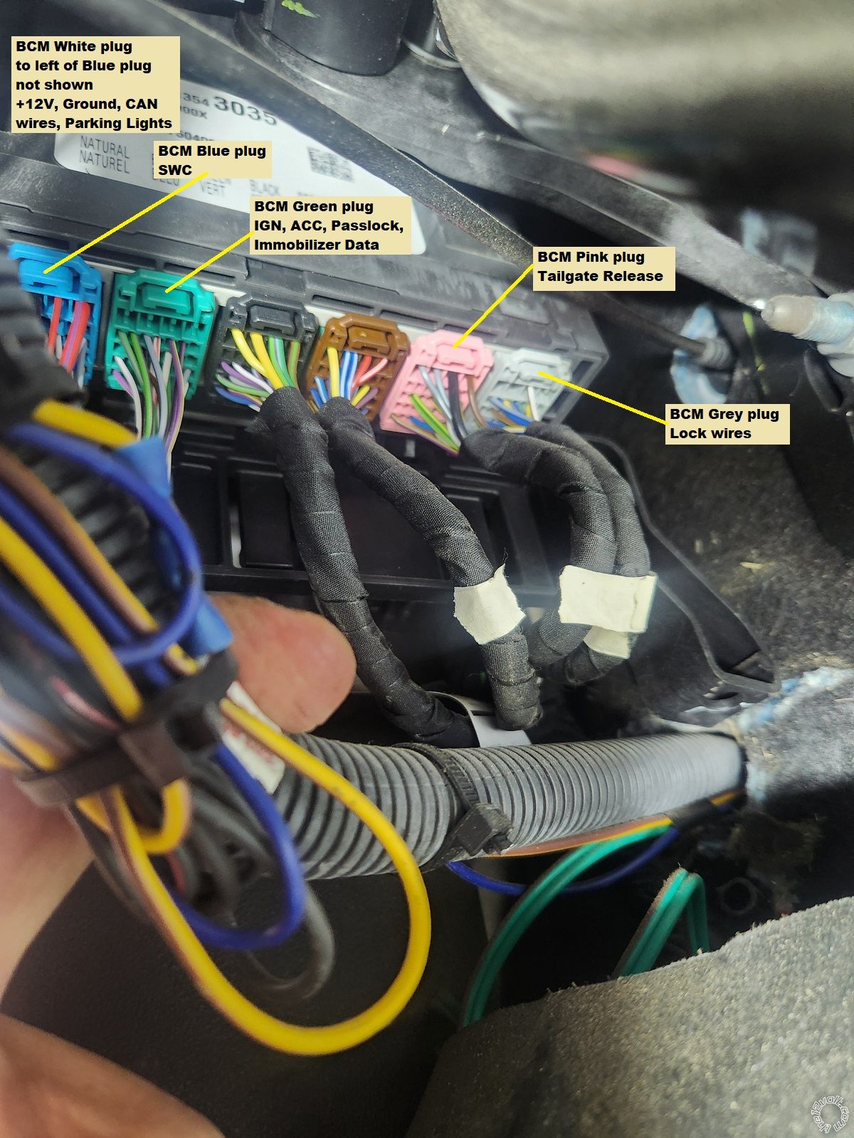

For best BCM connector access the plugs can be removed from the BCM. It is recommended to pull the negative battery cable before disconnecting the BCM harnesses. BCM location and photo below :

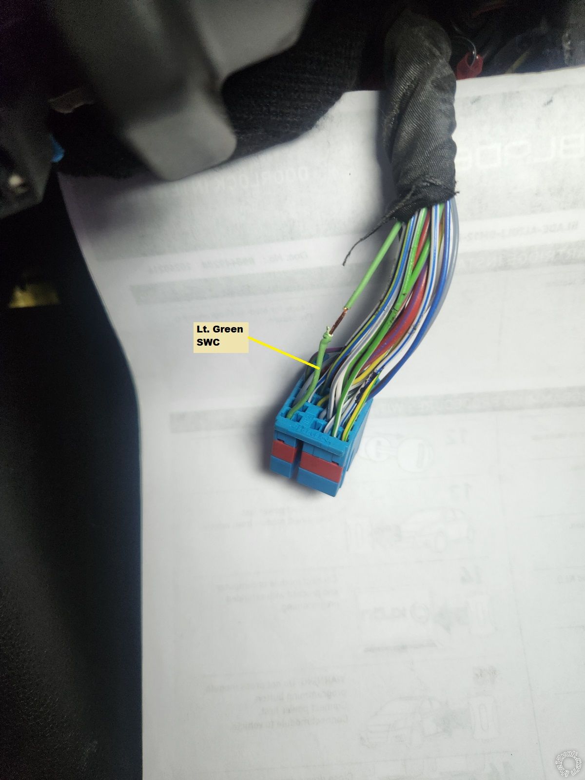

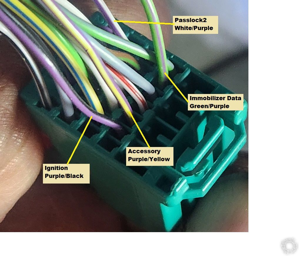

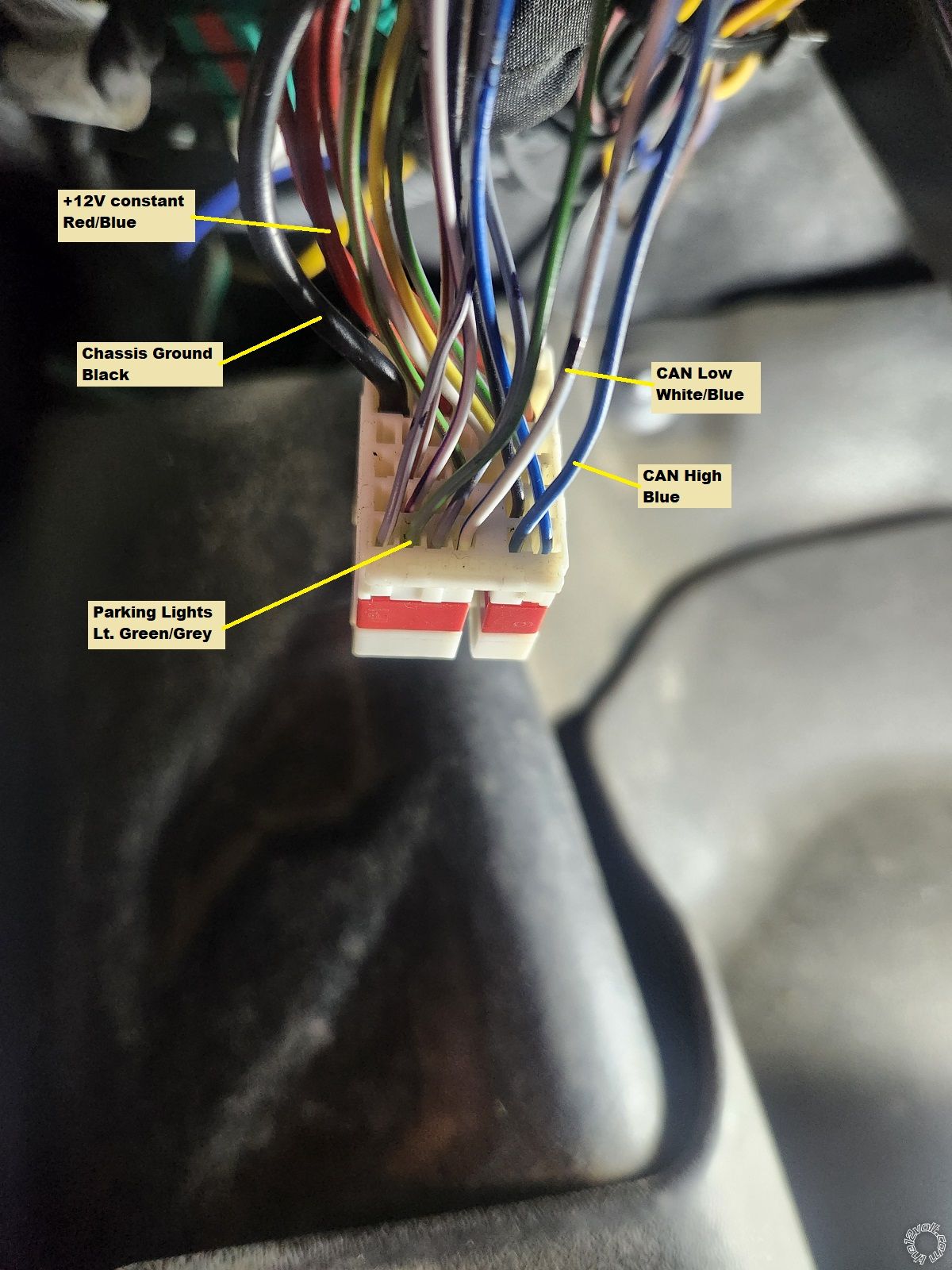

iDatalink provides very good photos and accurate wire info that is available while updating, flashing and configuring the modules. Here are photos taken during this install.

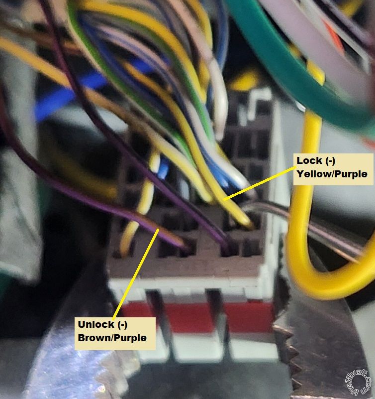

BCM X7 Grey plug

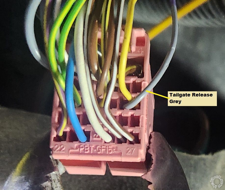

BCM X6 Pink plug
BCM X3 Green plug
BCM X2 Blue plug
BCM X1 White plug
