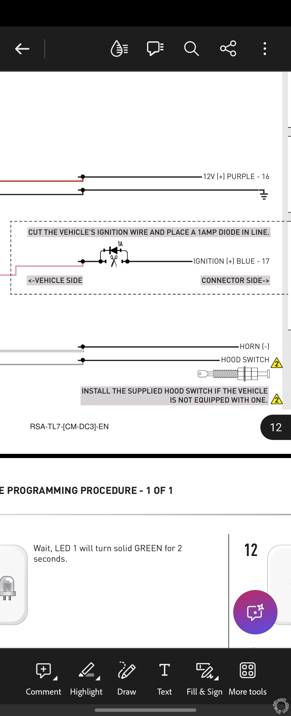

Hello, my first time doing a compustar dc3 remote start and want to make sure I do this right to achieve takeover on my 2022 prius prime. The wiring diagram below calls out for an in line 1 amp diode after cutting the blue ignition wire. My question is do I need to use two diodes? One for going from the pink ignition wire from module to the blue connector wire. Number 2 diode going from the existing blue wire we cut on vehicle side going back to the blue wire connector side. See attached image.

Oh wait! I think I had this upside down. The cathode side goes towards the pink ignition wire(from module) and blue wire(i just cut) on the vehicle side right? That makes a lot more sense to me.
