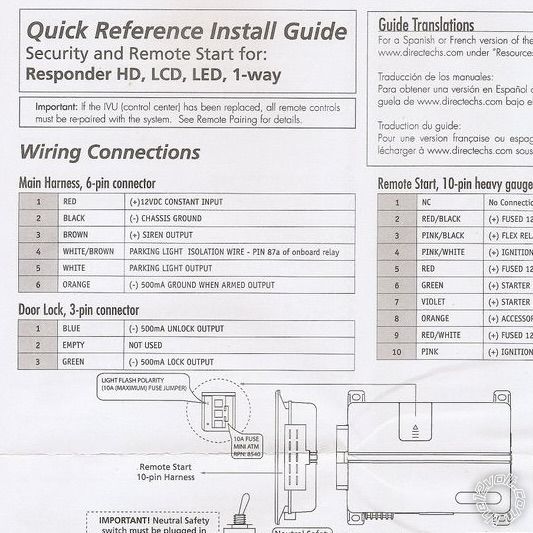

Hi everyone. I have a 2000 Honda Civic VTi (UK Si equivalent for the Americans) and I'm installing a Viper 5706V by myself. I have zero experience with alarm installations (Already a good start Wiring Hazard Lights Relay To Viper 5706V Alarm, 2000 Honda Civic VTi -- posted image.), but I've done a fair amount of research, to prepare myself.
Here is the diagram for the alarm:

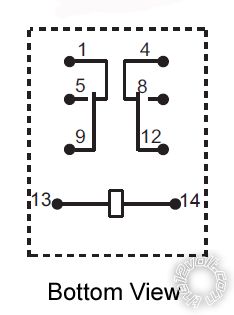

What I'm trying to do is wire the parking light output to my hazard lights, instead of the typical headlights and taillights. I just prefer this look because its more OEM. From my research, I need a relay to achieve this, correct? Wiring Hazard Lights Relay To Viper 5706V Alarm, 2000 Honda Civic VTi -- posted image. I bought a DPDT relay and here's the diagram for one:
Am I correct with this wiring?
13 - Parking light output of alarm (Defaulted to negative)
14 - Ground
9 & 12 - Constant 12V
5 - Left turn signal
8 - Right turn signal
1 & 4 - Unused
Do I need to change the polarity of the parking light output? There's jumper on the alarm itself. I'm worried I'm going to blow something if my wiring isn't right Wiring Hazard Lights Relay To Viper 5706V Alarm, 2000 Honda Civic VTi -- posted image.
Do I need to get diodes for what I'm trying to do?
I'm also having the relay piggyback on the alarm's main harness. As in 14 will go to black, 9 & 12 will go to red of the main harness. That's ok to do? If so, should I splice into the red before or after the fuse?
I should also mention, I'm not using the remote start feature of this alarm. Your help is greatly appreciated. Thanks Wiring Hazard Lights Relay To Viper 5706V Alarm, 2000 Honda Civic VTi -- posted image.
