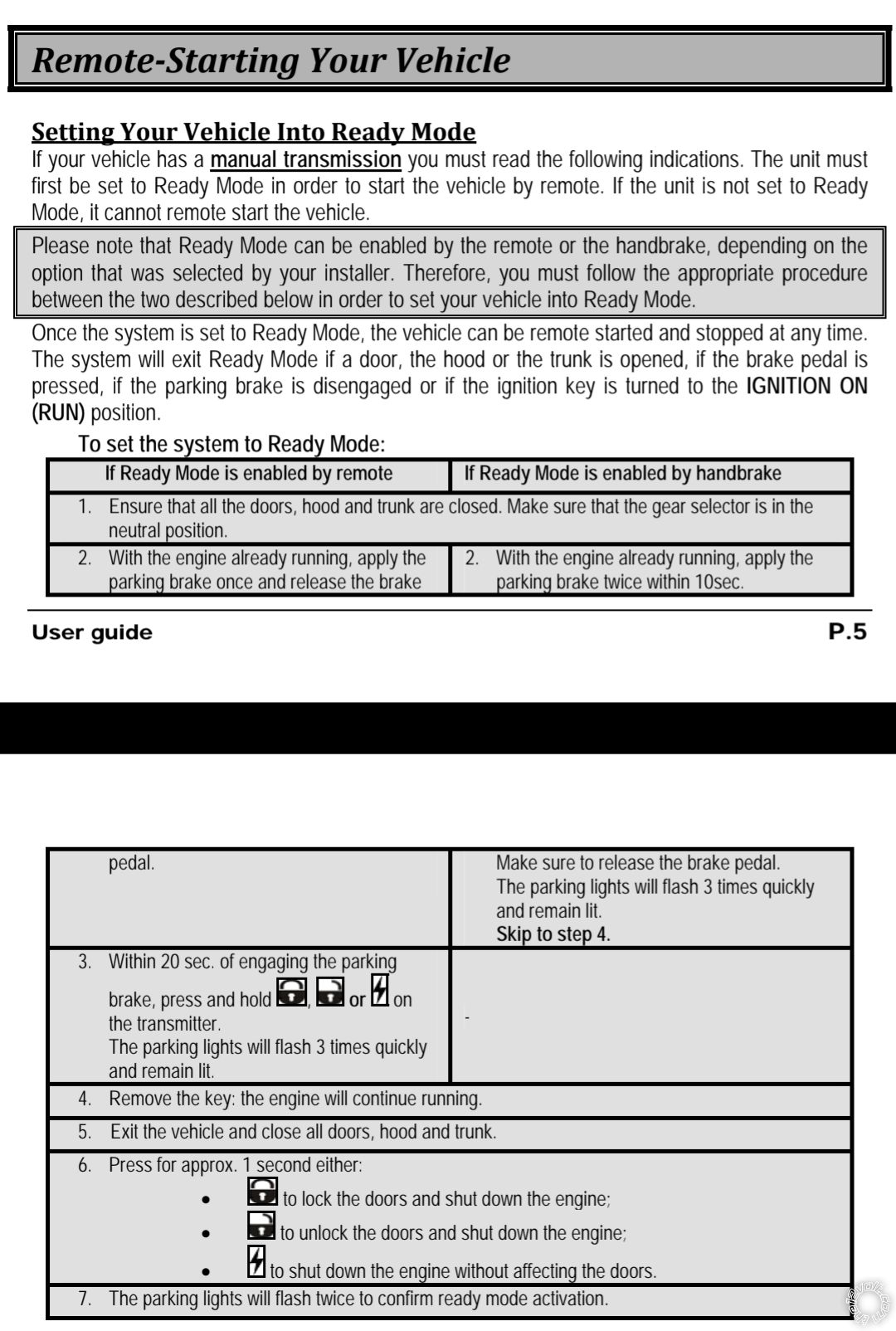

This is what I mean by setting up ready mode.
All of those steps below go through even the final step the parking lights do flash twice. It will then remote start but only once. If I repeat the steps below, it will remote start but again, only once.
All doors are closed, vehicle locked. It doesn't seem like it's an access point problem, I would assume if it was, it wouldn't remote start the one time directly after setting up ready mode. Vehicle in question is a 2012 Subaru Impreza if that helps.

Still slightly confused. I understand setting Ready Mode, Compustar calls it Reservation Mode.
If you set Ready Mode you can successfully do a R/S. This can be immediately after setting Ready Mode or several days later, if the cars status doesn't change (doors, trunk, brake, parking brake or IGN ON). Your problem is setting Ready Mode, doing a R/S, letting it run through the set run time and shutting down (or doing a manual shutdown) and then trying to do another R/S?
I'm not an Autostart user but perhaps the designers thought that an end user would set Ready Mode, R/S the vehicle, get in and drive away. When the end user next parked the vehicle, he would set Ready Mode again for the next time. It's probable that R/S'ing the vehicle and that process turning on the IGN would end/exit Ready Mode even if the customer never opened a door.

The manual for the system says after setting up ready mode the vehicle will remote start after without setting up ready mode again.
There is a trouble shooting chart in the manual with parking light flash codes but I don't get any flash codes on the failed remote starts.
It seems to me like it's loosing the ready mode memory. The manual says if the vehicle remote starts after setting up ready mode then ready mode has been completed successfully.

I'm with Kreg here. Regardless what the manual says, it's likely a typo.
You need to set this up every time. Otherwise someone will forget, remote start in gear and drive it into another car or a building.
