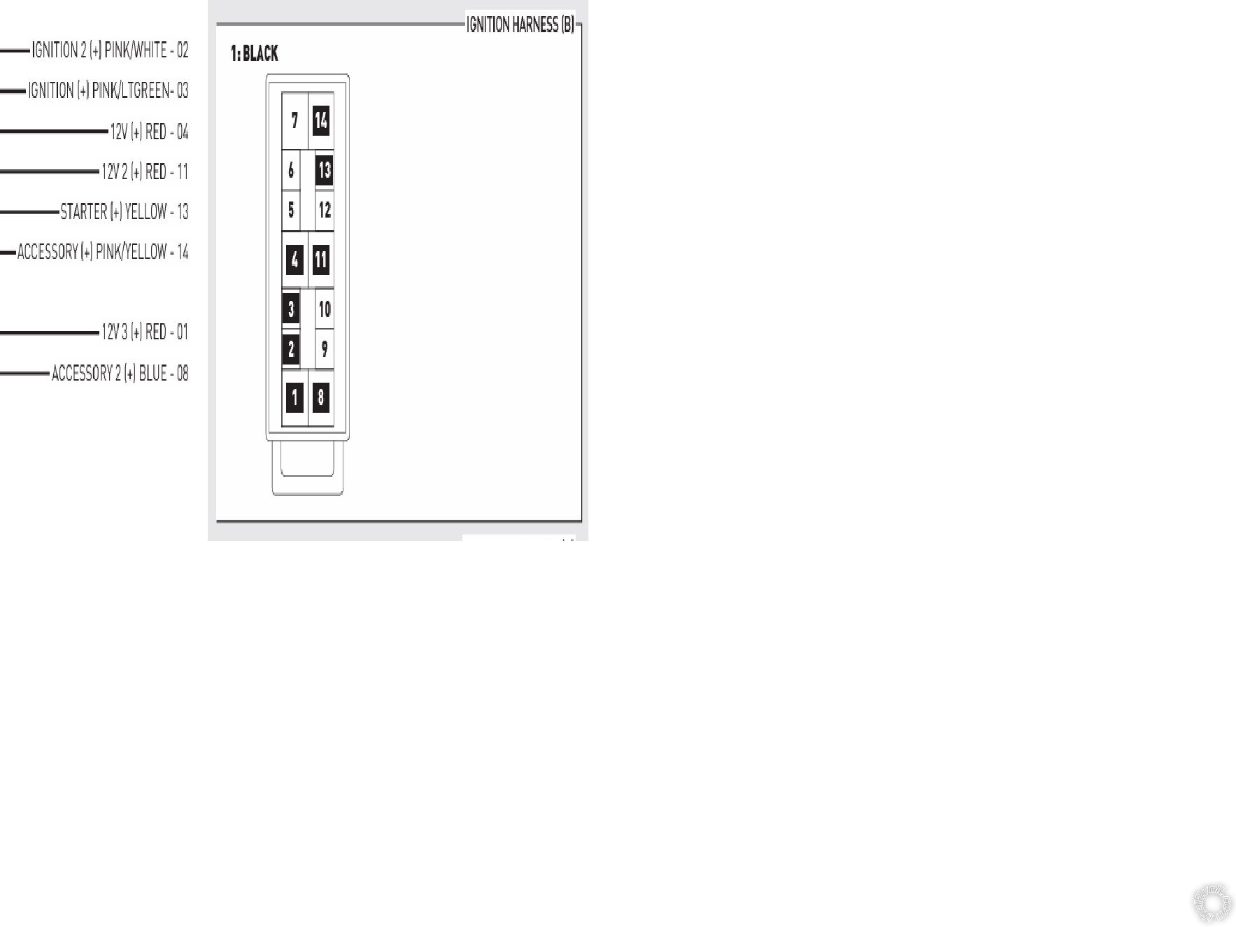

Use all three Red +12V constant ignition sources. Your main problem is the Vipers three +12V fused inputs (Red, Red/White and Red/Black). You want to connect the Red/Black fused wire to +12V constant. This wire supplies power for the Starter and ACC1 outputs. The extra relay for ACC2 is good.

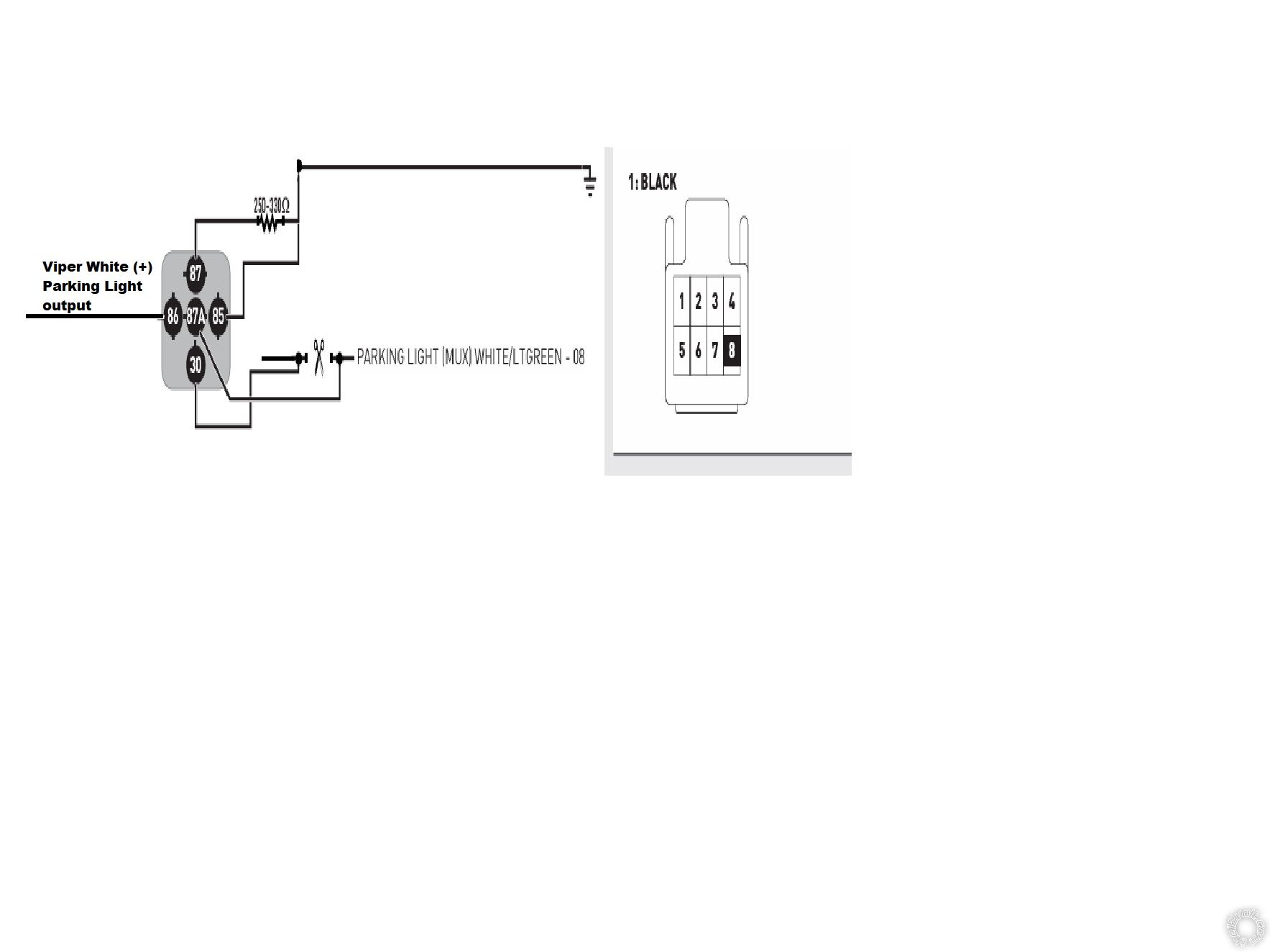

Parking Lights are a MUX type control at the steering column. You will need another relay and resistor to get the R/S to turn them on. Diagram below :
