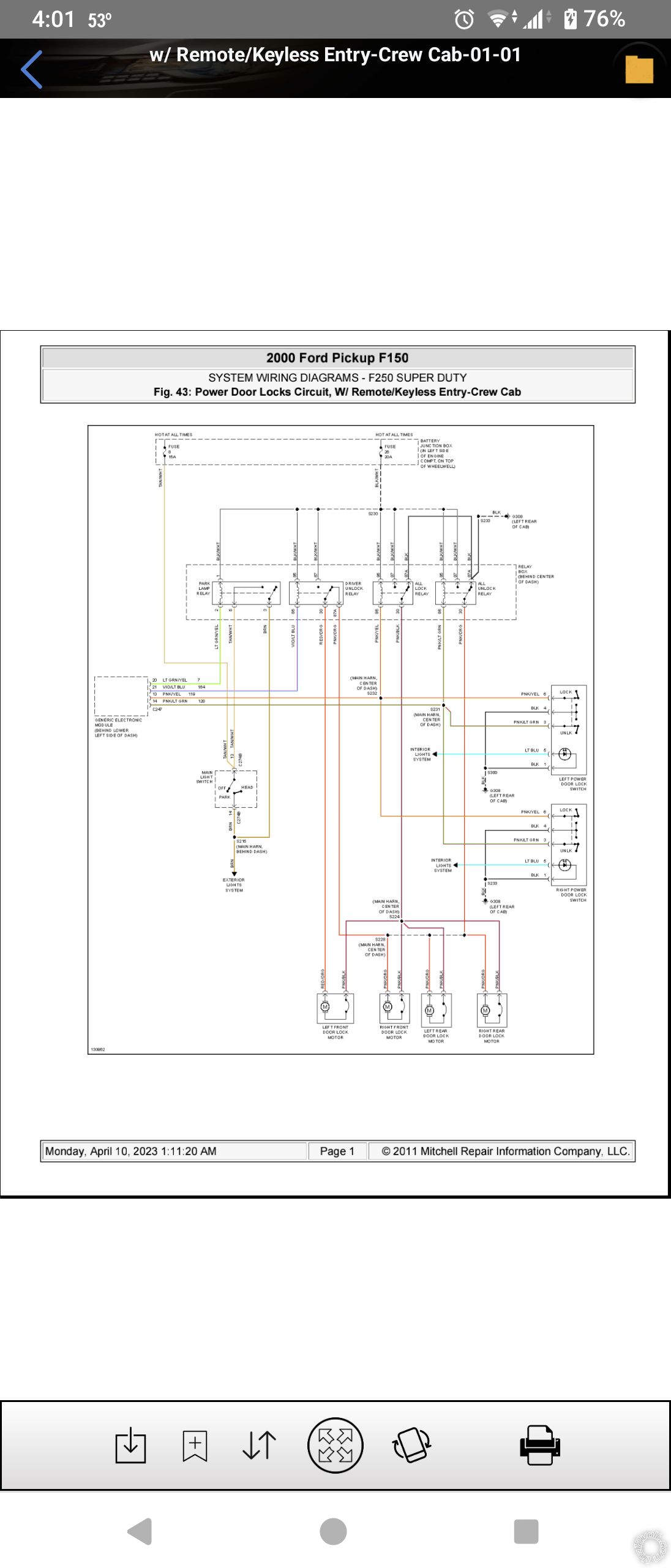

You can trace the alarm wiring and check for any blown fuses, but the unit is likely fried. The door lock outputs are meant to drive relays and not door lock actuators directly. Note the factory diagram shows a 20 amp fuse at the top.
Adding Power Lock To Tailgate, 2000 Ford F-250 -- posted image.
Probably the simplest way to add on an actuator would be to connect to the wires of another actuator since you know it is wired correctly.
A better solution would likely be wiring in some relays or a 451M door lock relay module.

If your F250 is a Crew cab, the door lock wiring runs aft to the rear doors on each side of the truck, under the rocker panel trim in the front door openings; it just pops up. Go to the harness under the driver door rocker trim and connect to the pnk/orn and pnk/blu. These go to the rear door, so the tailgate will be on the second unlock, or unlock all doors, not with driver-only.(If the avital is wired this way.)
When I did my tailgate lock on my 99 I wired it to the door lock actuators as described above. I also put a relay in the tailgate actuator wire that goes (+) in Un-Lock. I wired the "trunk pop" output of the viper to the relay so I can unlock the tailgate without unlocking the truck. << Not necessary, but kind of cool.
#87and #86 to fused Hot at all times.
#30 To tailgate actuator wire that is (+) in Unlock
87a To Truck power door lock wire that is (+) in Unlock. (Pnk/orn in above schematic.)
#85 To Avital red/wht "trunk release" output.

i opted to tie into the factory wiring first, this worked like a charm ! So thank you for the helpful advice! I do want to try (davep's) method above for utilizing the "trunk button" It may not be "super useful" but it's a good project to get my feet wet in working with relays. So with that method i'll only need one relay correct ?
