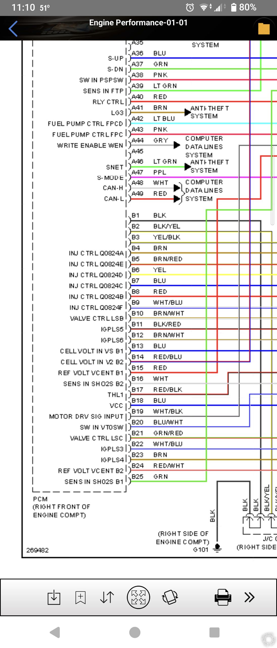

You should be able to get one of the injectors at the PCM. The B plug pins 4-9.
