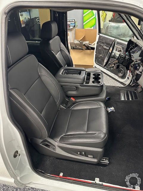

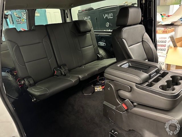

I have been struggling with the wiring for the new seats... I have acquired seats from a 2014-2018 Tahoe/Suburban and I was able to figure out the front seats and jump seat/console and am very happy with it. I have installed the rear seats and trying to power them up. I have confirmed the two wires needed to power the Fold Up/Down motor and am now trying to wire in the switch.

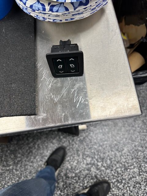

The new switch is from a 2021 Cadillac XT6 (rear seats)

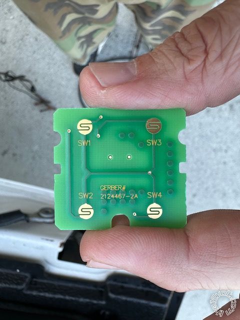

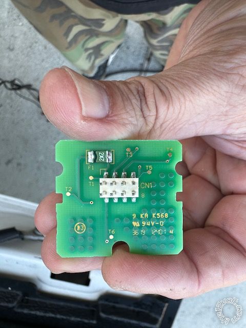

I need to know exactly how to wire the switch. The switch PCB shows the T3 Left Up, T4 Left Down, T5 Right Up, T6 Right Down with T1/T2 being the other side of all of those... Now What???? Is a relay needed? If so, how is that wired in?

On the above diagram to actuators = the 2 wires on the motor. Alarm lock and unlock output = the 2 outputs of your switch.
Apply ground to T1 and T2
You will have to build 2 of these. 1 per seat.

Thank you very much for the reply and the diagram. This would have worked if I saw it in time... I was told from a different source that I would need relays to make it work since I no longer had the seat modules. So I youtubed reversing polarity with 5-pin relays and came up with a couple good videos that showed your diagram in working order. From there it was fairly simple... Power into T1/T2 and then T3,4,5,6 out to each individual relay. Relays grounded and power out to each direction of each motor. Works flawlessly!
