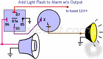

Explain L And X On Flasher -- posted image.
This might be a very silly question, but I'm new to alarm systems. If the alarm doesn't have a siren, we need to add a relay to connect it to the horn. My confusion is, what is that object contain x and L
Where is pin 30 going.
Thanks

X and L are a flash module, like for turn signals on older vehicles.

L= Load
