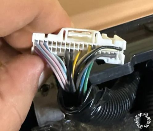

Hi everyone,
My Nissan Sentra 2023 has a Bose sound system and AVM (360 camera). What does the 40-pin connector look like? Here's a photo of it. Thank you in advance for your help. The camera only has these two pins near the CAN bus lines, but in other Nissan vehicles, there are usually two additional pins above them that provide power to the camera. Since the layout has changed, where did those two wires go? Could it be that they are the last two pins on the right (white and gray), next to the GND? I need the wiring diagram because i want to replace my factory head unit with an Android radio.

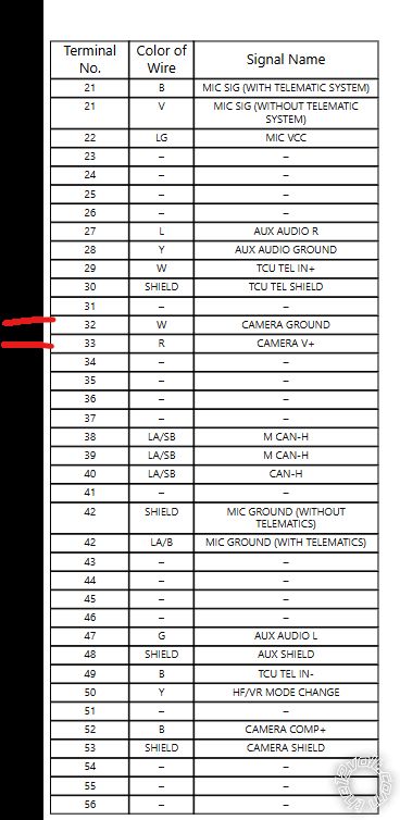

Strangely enough, I checked the manuals from 2022 to 2024, and in all of them, the 40-pin connector includes CAMERA Power and CAMERA GND, located right below CAMERA Signal and CAMERA Signal GND. However, in my model, there's only the RCA (CAMERA Signal and CAMERA Signal GND)—nothing else.
2023 Nissan Sentra, Radio Wiring Diagram -- posted image.
It's really bizarre. This model is manufactured in Mexico and sold both in Brazil (where I live) and in the U.S.
That means it's basically impossible to use any head unit other than the original Nissan one...

Probe back at the camera. You may be able to tie in back there. Worst case, use an aftermarket camera. Then you're not stuck with a factory setup.
