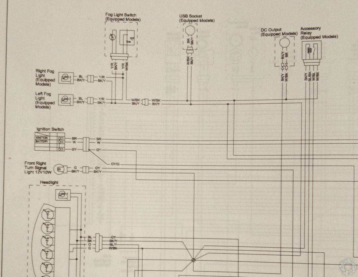

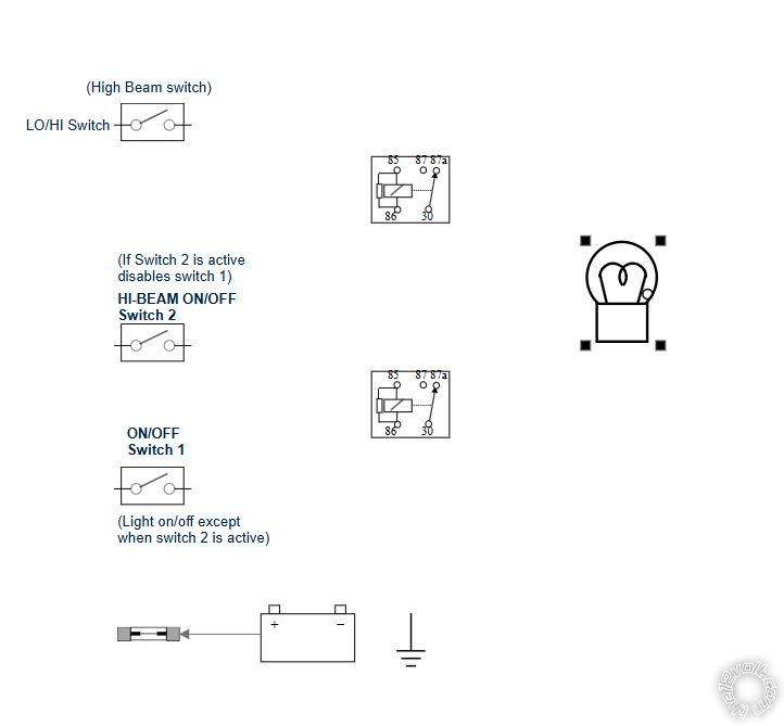

Hi, I'm in need of assistance with Dual Purpose Fog Light Wiring. Can someone please help me complete the following Wiring Diagram.
Also attached the wiring diagram from the workshop manual.
Thanks in advance.
There are Fog Lights already wired to an On/Off Switch (Switch 1).
I would like to:
1. Add a 2nd On/Off Switch (Switch 2) that will allow the Lights to be controlled by the Hi-Beam Switch.
2. When Switch 2 is active, switch 1 to be Inactive/Bypassed.
Template Download

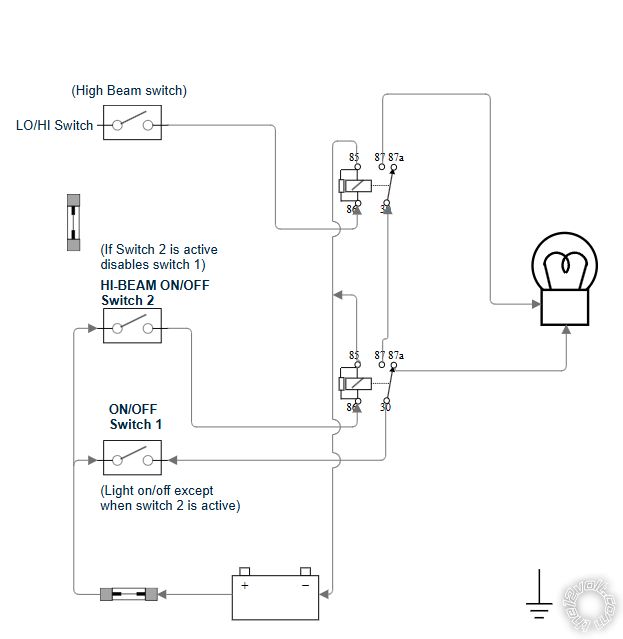

Would this be okay?
