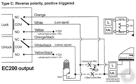

2005 Dodge Grand Caravan with factory RKE (not working) and factory security system (not working remote)
I am trying to install an EasyGuard EC206-B 2 Way car Alarm
My difficulty is that there are four wires coming from the BCM, 2 going to the Left door and two going to the Right door. The voltage pulse is 12v whenever the locks are triggered for lock or unlock. So it seems to be a reverse polarity system. Tan/White for Lock and Tan/Light Green for UnLock on the Left door and Tan/Brown for Unlock on the Right Front Door and Tan/Gray For Lock on the Right Front Door.
2005 Dodge Caravan, Door Lock 2 Wires To Each Door -- posted image.
The alarm controller only has one wire for lock and one wire for unlock.
Am I supposed to Jumper the Lock wire from the two front doors together? And do the same with Unlock wires?
Just not sure how to go about this. Any advice appreciated.

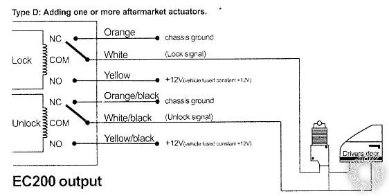

Platinum - Posts: 13,728
Posted: October 09, 2025 at 7:53 PM / IP Logged Link to Post Post Reply Quote i am an idiot
Ground to the Orange and Orange/Black.
Power to Yellow and Yellow/Black.
Lock wires from both doors to White.
Unlock wires from both doors to White/Black

Hello IAAI (or anyone else who might respond),
On this 2005 Dodge Grand Caravan.....
According to the User Guide that came with the alarm, the above instructions are for Aftermarket Actuators
However, when I measured the signal going to the door locks I got 12+ for unlock and 12- for lock.
I was thinking (possibly wrong) that this meant it was a reverse polarity system and would be wired accordingly?
I do not doubt the advice given, just curious as to how the aftermarket actuator pulses differ from the reverse polarity setup?
Thanks

Posted: November 16, 2025 at 3:47 PM / IP Logged Link to Post Post Reply Quote aviator172
According to the installation instructions, this is the Positive/Negative Connection method, which seems like the correct method for this 2005 Dodge Caravan. But for some reason it isn't working.
When I measure the output in the OEM wiring I get 12v pulses but the alarm is only delivering 2volts. Odd. More checking needed.
