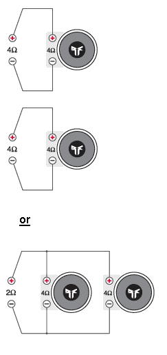

The physical installation of subs is no big deal (assuming you buy an enclosure instead of build one yourself). All you really have to worry about is the wiring of the sub itself (if you buy DVC's) and the connection from the sub(s) to the amp. And just like any other speaker, you obviously don't want to physically damage the sub during installation!
Choosing which sub(s) and amp(s) to buy is another question all together. Do you have any ideas of what you're looking for yet?
When you choose an amp and subs, you need to look at the RMS ratings and Ohms of each (because the total ohm load decides how many watts the amp sends to the subs).
If you are looking at getting two 4ohm SVC (Single Voice Coil) subs rated at #RMS, then you want an amp that will produce either "#RMS x 2 @ 4ohms" or "(2 * #RMS) x 1 @ 2ohms". For example, if you had two 4ohm SVC's rated at 200watts RMS, then you would want an amp rated either at "200 x 2 @ 4ohms" or "400 x 1 @ 2ohms".
Here's a diagram of the 2 examples...
help me out here! -- posted image.
