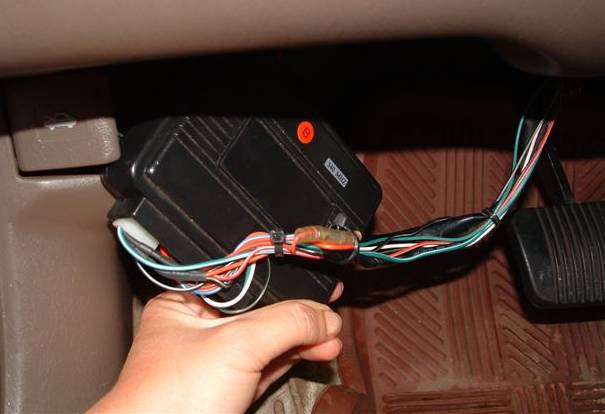

bleedsoe9mm
Joined: June 14, 2003
Posted: June 15, 2003 at 1:46 PM / IP Logged
94 camry remote starter problem -- posted image.
Chris Luongo
Platinum - Posts: 3,746
Joined: May 21, 2002
Posted: June 15, 2003 at 7:27 PM / IP Logged
Bleedsoe, I don't recognize that particular unit, but pictures are always good!
After your battery died, you must have had to jump-start the car, right? Often, fuses in the car will blow during a jump start---I'm still not sure if this is from someone connecting the jumper cables backward, or for some other reason---but at any rate, it does happen sometimes.
If you follow that wiring, it's gotta have fuses on it somewhere. They may be under the dash, or near the battery----it can never hurt to check them.
It is also a wise idea to somehow interrupt power from the unit for a few moments, and then reconnect it and see what happens. You can do this by disconnecting the fuses as nighthawk said, or unplug the wires going to the brain. You can also just disconnect your car's battery, but that's no fun because you lose your clock and radio presets.
If the installer has installed a hood pinswitch for safety, there is also the very small chance you disturbed it while getting the car jump-started. Make sure it looks like it's in good shape, and that it is getting pushed down when you close the hood.
bleedsoe9mm
Posted: June 15, 2003 at 8:58 PM / IP Logged
i don't think its a fuse , the door locks are working it just won't start . my problem is the first owner of the car had this unit installed so i have no manual on how to reprogram it . the same thing happen last summer and i took it to apple autoglass (the original installers) he was able to reprogram it without going near a fuse which cost me $50 . i don't want to take it back unless i have too . if anyone regonizes this starter let me know .
