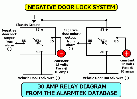

You were misinformed on The 2000 Expedition.
This is a 3 wire (-) system. To test, find the pink / YELLOW, and pink/light-green wire in the drivers side kick panel. Once located, using a simple 12 volt test light, ground the clip to the chasis, and then probe one of these 2 wires. When you send a ground, throught the test light probe, it should lock/unlock depending on the wire probed.
This denotes a 3 wire door lock, just directly connect the (-) door lock outputs from your system to the corresponding wires in the truck. Done. If you find anything different, let me know, but it's doubtfull. Most every Expedition I have ever installed in was a Neg system.
Good Luck.
By the way, here is 5 wire reverse door locks from my site at www.RELAYHELP.com
5 wire positive door lock/unlock -- posted image.5 wire positive door lock/unlock -- posted image.

so basically just take your r/s door lock wires and attach them correctly to the oppsing lock and unlock wires., and then tape them up test make sure lock is lock and so forth for unlock. thats it now relays no nothing .
