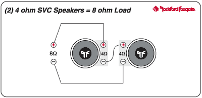

Anyway, if you're bridged in Series then you have an 8ohm total load (two 4ohm SVC's in series = 8ohm total load). You're current setup probably looks like this..

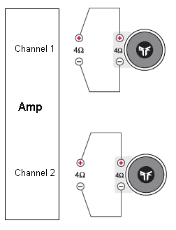

To get the Most out of you existing equipment (safely), you should wire your subs 1 per channel for the 80 x 2 @ 4ohms rating. Wire like this...
