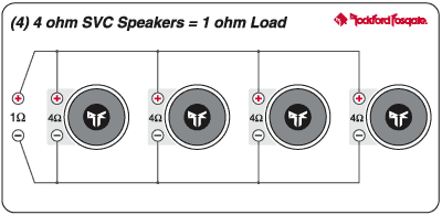

Ihave 4 rockford fosgate speakers two of one model and of two of another is it ok to put in one single box together If so what would be the best way to wire them they are all single voice coil  4ohm

Yes, it should be ok as long as the divided RMS output of your amp does not go over the RMS rating of each sub (going over a little is ok, but you'll get longer performance from the subs if you stick near the RMS ratings).
When you refer to 2 different models, are you trying to say 2 different sizes? Like two 10's and two 12's? Or are you saying the same size subs, just 2 newer and 2 older?
If you are using 2 different sizes then you need to adjust the volume accordingly. You would be better off using a seperate enclosure for each sub, or 1 enclosure for 1 model, and 1 enclosure for the other model.
If your amp is a 1ohm stable Class D amplifier, then you can wire them in parallel like this for a 1ohm total load...

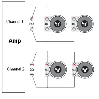

If your amp is a 2-channel 2ohm stereo stable amplifier, then you can wire 2 subs in parallel to 1 channel, and the other 2 subs in parallel to the other channel like this....

If you give the specific make and model numbers of the subs and amp then I can tell you if it will work or not.
