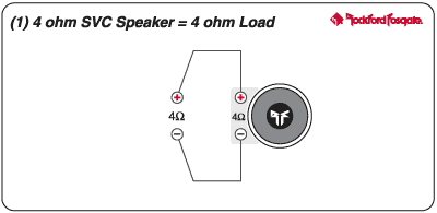

(1) 4ohm SVC sub
Sub1 is a 4ohm Single Voice Coil sub rated 500RMS 1000Peak.
Since it is only (1) 4ohm SVC, you can only wire sub+ to amp+ and sub- to amp- and the total ohm load will not change. It would look like this...
confused watts -- posted image.
And you would want an amp rated 500 watts x 1-channel @ 4ohms.

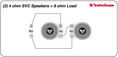

Series: Connecting amp+ to Sub1+, Sub1- to Sub2+, and Sub2- to amp-. Wiring in series doubles the ohm load. So two 4ohm SVC subs wired in series would produce an 8ohm total load to the amp, and it would look like this...
An 8ohm load is not going to give much power, so you would want to look at the wiring configurations for 2 and 4 ohm loads. Using the specs from Sub1 and Sub2, you would want either a 1-channel amp rated 1000watts x 1-channel @ 2ohms (the total watts rating gets divided by the number of subs, so each sub would get 500watts), a 2-channel amp rated 500watts x 2-channels @ 4ohms (each sub wired to it's own channel), or a 4-channel amp rated 500watts x 2-channels @ 4ohms mono/bridged (when you bridge an amp you are combining 2 channels into 1, in this case channels 1 and 2 are being bridged into 1-channel, and channels 3 and 4 are being bridged into 1-channel, thus creating 2 mono bridges)
