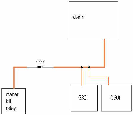

Here is how you should hook up the diode....I posted this picture in another post before. The 530t is my window module. I have 2 modules, but you can hook yours up in the same manner.
need help window module -- posted image.
So you'll have the striped side of the diode going towards the alarm. I usually just buy a small pack of diodes from RadioShack. They're the 1N4004 diodes.
