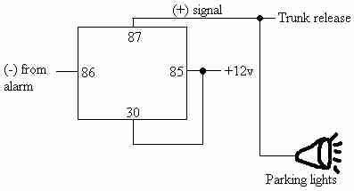

Better said with a picture :-)
(Gee, and my old alarm used to light the parking lights with everything you did.)

Yes, that is the correct connections. I would still use another relay and isolate the 2 circuits from each other ( just in case ). It's only a 50 cent relay and it couldn't hurt to be cautious.

With the diagram above, anytime your parking lights are on, your trunk will open. You'll need to isolate the parking lights from the trunk release with another relay.

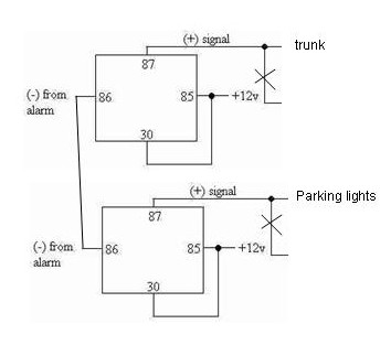

Like so?.........(for the meantime, I ran out of relays:)

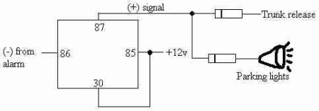

Don't think you can find a diode that can handle that kind power.
1 relay for trunk pop and parking lights? -- posted image.
cpgoose
Gold - Posts: 1,098
Joined: July 08, 2002
Posted: September 15, 2003 at 9:43 AM / IP Logged
You beat me to the punch 12volt....but I guess this is still wrong. I didn't think having the parking lights on would do that....but I guess I thought wrong. Oh well. Thanks for the quick input everyone.

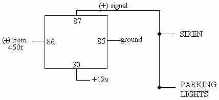

Can I throw another question on here? I'm assuming this will work in the same manner. I have a DEI 450t channel expander. The expander has a brown wire that goes right to the alarm siren's wire (no relay needed) that chirps the siren everytime you hit the aux button (so you know which channel you're using). It says if you don't have a siren, you can put the brown wire to a relay, and have it blink the parking lights. I would like to accomplish both, so do I just need 1 relay? Can I put the brown wire from the expander to the relay, and then attach both the parking lights and the siren to the relay?
Again, better explained with a picture:
THANKS!
