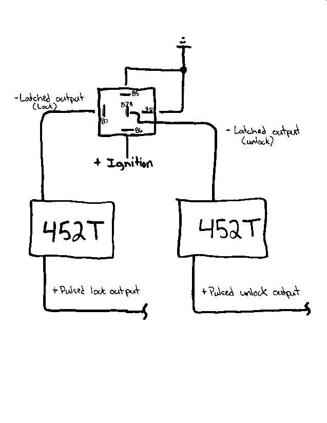

1nicemustang
Copper - Posts: 89
Joined: August 19, 2002
Posted: October 25, 2003 at 6:13 AM / IP Logged
ok lets try the hook up on this........
i would use the hot at ignition only wire as the trigger.
wire the outputs lock/unlock to the existing keyless entry.
and maybe a ground wire from the module.
now....i have factory keyless entry.......i have a ford series 4 alarm that also operates the keyless entry as well as locking/arming etc.
will integrating the dei 452t cause a problem or feedback into the system any?
if not you seem to have found the problem solver for me then.
Let me know your thoughts on this.
NSGrimace
Member - Posts: 30
Joined: October 23, 2003
Posted: October 25, 2003 at 11:41 AM / IP Logged
I am not 100% percent sure of the wiring characteristics of the module, but what i can see from sales adds it looks like you might need 2 of them to complete the project along with a SPDT Automotive relay. The schematic below shows the basic idea of how it should work, granted my assumptions on the 452T are correct. If you can find an installation manual for the module I will be able to give a definate answer.
** Note - The modules on the schematic do not have all wiring info includedignition controlled door locks -- posted image.

1nicemustang
Copper - Posts: 89
Posted: October 25, 2003 at 2:01 PM / IP Logged
nope just a factory keyless system 4 with siren, dual shock sensor, and igniton cut off.
this was going to be a winter project just to see if id be able to pull it off or not. but the above example makes sense to me. they modules only cost 7 bucks so i can purchase one and see what the wiring says on it.
