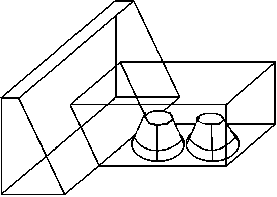

hey, i have a 1976 chevy silverado fullsize single cab p/u.  right now i have a bench seat.  i plan on getting 2 bucket seats.  i wanna build a sub box that has a wedge box behind the seats and has a part of the box coming up like a console.  i made a couple rough sketches of what it will look like.  i want to get either two 12s or two 10s.  the subs will be facing down in the console, with plexiglass for to make it look good.  i might do with out the plexiglass, not sure yet.  anyways, what subs would you guys recommend?  i was thinking maybe JL 12w7 or w6v2, but im not sure.  any ideas or comments greatly appreciated.  thank you.

i used the volume calculator, and i would have just shy of 5 feet.  i dont care about price, i get most stuff at cost so it doesnt matter. i want the best subwoofer that will give me the boom and will be good with the volume of the box.

Actually I get about 3.87 cuft with your enclosure design.  Do you intend it to be sealed, ported, bandpass, what?  Where do you plan to mount the driver?

i get 4.43 cuft.  with 3/4 thick wood.  can you double check?  anyways the driver will be firing down in the cosole part of the box.  i put a picture here, but sometimes they dont work.  so i tried to explain somewhat above.

What you have drawn is basically three shapes put together.  Using 3/4" MDF, your gross internal volume would be:
15 x 13 x 24 cube = 2.02148 cuft
15 x 13 x 3 triangle = 0.06738 cuft
62 x 16 x 7 x 4 trapezoid = 1.78121 cuft
Total = 3.87007 cuft.  If you plan to mount a woofer down firing under the plexiglass, then the dimensions above are incorrect, as there will have to be another piece of MDF inside the enclosure to mount the driver on, and you are actually then building a band-pass enclosure.  Where are your ports?  The shape you have drawn will probably not result in very good sound as a bandpass, as your tuning frequency would end up somewhere around  70 hz.  Plus not only would it be difficult if not impossible to find a speaker that would work well in such an enclosure, finding one that would also handle being mounted down-firing is more difficult yet.  If you can find a driver that would work in this, I do not envy you the problems you will have with this enclosure; not only getting it put together in the first place but the required internal bracing will be a b**tch.
Regardless, nothing you do with this shape would work very well with a JL 12W7 as I believe that driver works best in a 1.8 to 2.0 cuft sealed enclosure.
If you are locked in to this geometry, your best bet might be to abandon the idea of having a down-firing driver under your plexiglass window, make the front piece a little wider so you can mount a 12" Eclipse Titanium facing the front, and put ports in the top of the back area.  Eclipse Titanium 12" will function pretty well in a 4.0 cuft ported enclosure.

How much room is their between the bottom of the plexi consul (where you show the subs mounted) and what ever is below it? But before designing a box I would fist suggest you find a woofer(s) so you calculate / build the appropriate enclosure.

DYohn,
 i know that you are far more experience with this stuff than i am.  but i still think that you are incorrect on the volume of the wedge section of the box.  if you look on the volume calculator,  the box is laying in a different position as my proposed box.  on the volume calc.  the parallel sides of the box are vertical, and on my box they are horizontal.  you needed to imagine my box laying with the parallel sides vertical, and then plug in the values.  thats how i got 2.41142 cuft for the wegde portion of the box.  i can see where you made your mistake.  they way it should be is:  width - 62",  Height 1 - 7"   , Height 2 - 4" , Depth - 16", and thickness at .75",  which gives you 2.42242.
