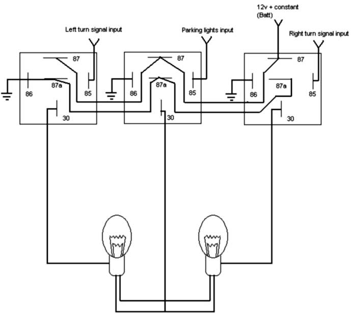

Hey i did thise before with my old car but i lost my diagrams...
I have a dual filiment blinker bulb.
Cars oem factory settings are as follows:
P=parking signal (lights) (+) ; B= Blinker signal (lights) (+)
P= off / B= off --> - low wattage filliment is off & high wattage filiment is off
P=off / B=on--> - low wattage filliment is off & high wattage filiment is on (at pulses on/off/on/off etc)
P=on / B= off--> - low wattage filliment is on (at constant power - no pulse) & high wattage filiment is off
P=on / B=on --> - low wattage filliment is on (constant) & high wattage filiment is on (pulses)
Now.... I want to change it to:
wishful settings are as follows:
P=off / B=on--> - Both High & low wattage filliments are on (at pulses on/off/on/off etc)
P=on / B= off--> - Both High & low wattage filliments are on (at CONSTANT no pulse)
P=on / B=on --> - Both High & low wattage filliments are off (at pulses off/on/off/on etc) = "idea?: maybe have two (+) to eachother canceling out the stream ?"
i want to do this for just my front blinkers for right now...
car using a dual filiment bulb  3 wires coming for the bulbs (parking) (ground) (blinker) above are details///
let me know if you can help me with any of this  ;)
Thank you
David"

low wattage filament = park light
high wattage filament = turn signal...

well, you can do what you want, it's pretty easy.  you COULD try tying a positive from each (one wire, like parking lights to one side of the filliments, the other wire, the turn signals, to the other side of the filliments.... only problem is, in the daytime with the headlights off, when you hit the right or left turn signals, it will not balance correctly since you're lighting both the high and low elements on the front bulbs (i.e. it will pull so much current, that you'll end up lighting up the rear parking lights in order to turn on the turn signals).  actually, they wont light all the way, you'll just end up with a bunch of dim bulbs.  to eliminate the need to rely on using the bulbs that are not in operation for grounding bulbs that ARE in operation, you could use something like this diagram (it requires that your bulbs sockets do NOT ground the outside part of the bulb when it's plugged it into the socket) - you tie the common filliment wire (that's normally the ground) to pin 30 on the two outer relays, and tie the other two filliment wires (normally the parking lights and the turn signal light wires) together, and tie to pin 30 of the center relay.  the relays provide direct ground and direct battery hot, so there is no reliance on other bulbs being used as ground, and making all of them dim (which would happen mainly in the daytime - when you need them the brightest).   anyhow, here's the diagram:
blinker pulse change off->on to on->off -- posted image.

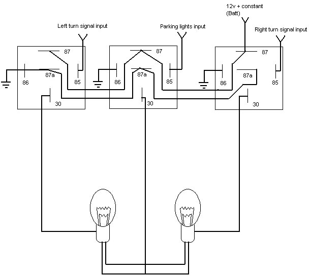

yikes!  that pic didn't come thru very well, i'll try again......
