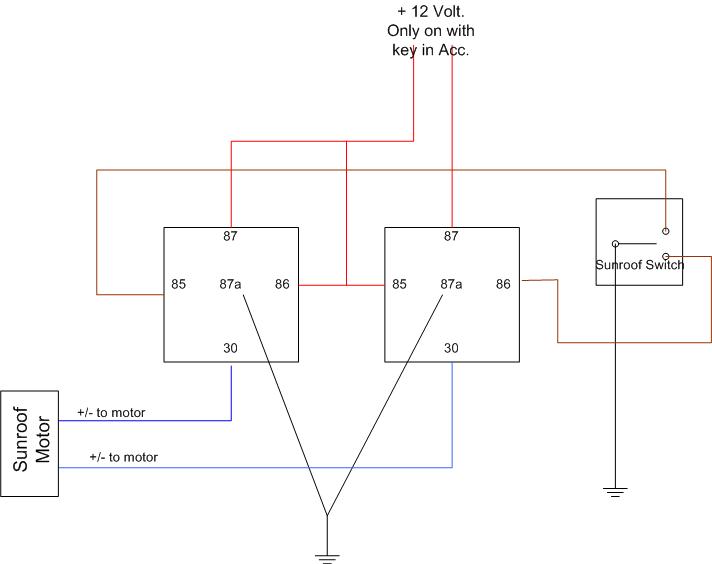

99 Honda Prelude Sunroof -- posted image.
Thats is how the motor for the sunroof is controlled.  In order to remotely control the motor, you would have to apply power to all the +12v wires because they are off when not in accessory mode. You can use the negative output from your alarm to control open and close.

Thanks guys I knew it would take more than one relay. Someone told me it was impossible, but we all know better!

Can someone please give me a printable picture and a little more info?

Wont I need a latching output? A trunk release signal wont be enough to run relays.

thats correct you need a lacthing output but with the dei 529 you dont its single
