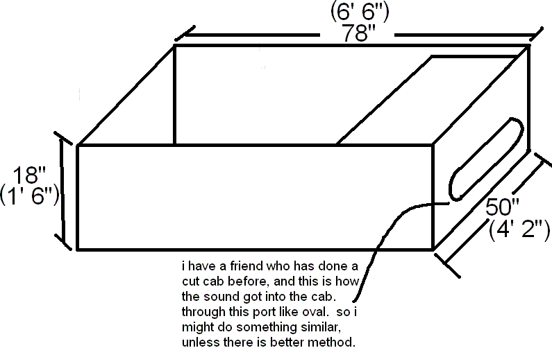

i have very little room behind my seat, i have a wedge box behind my bench seat right now, and my seat is all the way forward, and i have very little leg room, so if i did the cut cab, i could scoot my seat all the back and just have my subs in the bed.  i would have the box all the way up against the front on my bed, and then have a hole the goes through into the cab,  i sketched a quick drawing to get a better idea of what its gonna be.
Cut-Cab Speaker box -- posted image.
bberman1
Gold - Posts: 2,314
Joined: March 11, 2002
Posted: December 24, 2003 at 6:30 PM / IP Logged
Your pic doesn’t show!
