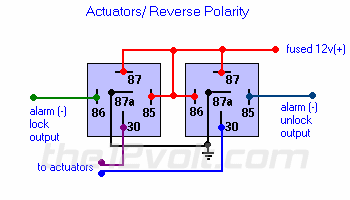

hey guys,
i posted before asking for help, but for some reason it didnt show up
basically..i have an avital 2200 series alarm installed (by me) in my 93 ford ranger stx. I added two wire power door lock actuators into the doors, and they are functional when i manually apply 12 volts to one and ground to the other. (of course) i need to know what wires from the 5 wire harness (145m relay) the 145m relay plugs into my alarm, and it works, as it clicks when i hit lock/unlock (arm/disarm) what wires do i need to hook to the actuators? from my understanding, 4 of these wires are for actuators, alternating 12 v pulse and ground?
thanks,
mark

iono how you set up ur relay but its suppose to alternate grounds only if youre using teh common two wires actuators. 93 Ranger, avital 2200, actuators -- posted image.

i have no idea how to interpret that diagram...at all..can you please explain that to me?
