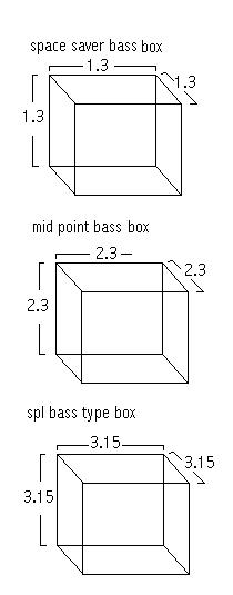

audiobahn aw1208t, box size? - Page 2 -- posted image.this is what i understand but that's about it... now i don't inten to enter any spl ompetition . but i want to get the best bass out of them...so i think the box has to be 6.30cu feet.i have the space i have a blazer s-10 and the back has to be at least 8cu feet but  to a 10cu feet. now is there a lot of difference bwtween the spl and the everyday base box (or midsize one)

seriously you dont need a box that big to have big hard hitting spl. not even for every day listening bass. my suggestion is, since the subs need 1.5 or 2.5 make the box 3, 5cu ft. single chamber braced in the middle with your ports along with it..hell with these 12's you dont even need the other subs that you have..this way you'll have more room to put groceries or a prostitute or something in the back..ya know that extra space that you would like to have

theblack  lines in between divide  the chambers, iand now i decide to put the amp in the with the box b/c on the back of my car there 4 big ass bolts and i'm gonna use two of them to hold the box down in case of any stichy fingers...so i'm going to use haft of my truck to do the box i have no exsact measure (to cold to go outside now) but i'll get them by tonight or just baybe later...audiobahn aw1208t, box size? - Page 2 -- posted image.

welli've messure and this is what i have to work with   . i want to use al least have of it.. for everything amps, woofers, power caps... audiobahn aw1208t, box size? - Page 2 -- posted image.

for some reason the pic. didn't upload, so here it is ... terll me if anyone have any suggestions for my box. the floor,  back, front,left, right panel will be wood and the top is going to be fiberglassed..audiobahn aw1208t, box size? - Page 2 -- posted image.
