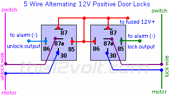

I had this alarm installed previously and it worked flawlessly.  I removed it from my Celica and im putting it in a 98 Ford Mustang.  I had a alarm place in the Flea Market install it, but they couldnt get the doorlocks to function properly.  The car had a factory keyless entry, yet when the alarm is hooked up it wont lock/unlock the doors.  The installers said it was a negative pulse coming out.  But that didnt help me much.  Im going to pick the car up, and I will probably work on it on sunday.  Any ideas of what could have happened?  I know that the wire for the locks on the brain unit IS cut.  Which im pretty sure it should have been.  Does anyone have any ideas or suggestions to try when I look at it?  Thanks!

The lock wires on the mustang are need to be cut and relays installed like this:
Aladdin a-2000 question -- posted image.

The wires on the Aladdin are set up for both (+) or (-) according to what polarity you have the P9 RED / BLACK wire hooked up to. GROUND will give the locking wires a (-) and 12 VOLT + will give the locks a + pulse.

So would you suggest that I dismantle my door and find all the wires in there?  Because I know that the harness coming out of the door has about 12 or more wires coming out.  The installer also said that the door locks were a negative pulse and shouldnt need relays... although he is the one that couldnt figure out how to hook it up.  And also the when I open the doors to the car the alarm wont go off either?  He couldnt get that working either... So would this also be caused by the lock wiring?  And last thing, would any of this be caused by the factory alarm disarm wire not being connected correctly?  Because I know i didnt have it connected correctly, and im not positive if the alarm guys fixed it?  Thanks again for the replies!
