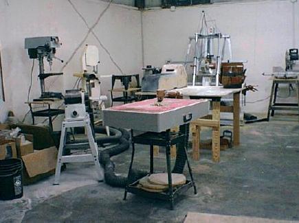

Here is how I set my shop up. Kinda messy, I am cleaning now actually, just took a break.
It is kinda tight, but it still functions. I use every tool very frequently except for the bandsaw. I think I need a different blade, it doesn't like to cut curves in MDF that is any thicker than 1/4". So I usually use the jigsaw then put the piece on the disc/belt sander table and shape it out.
I do wish I had room for a table saw though. My Vertical panel saw is the BOMB, but you can't cut angles on it.
The routers tables are by far the most useful pieces, especially after you start accumulating jigs.
Just my .02
