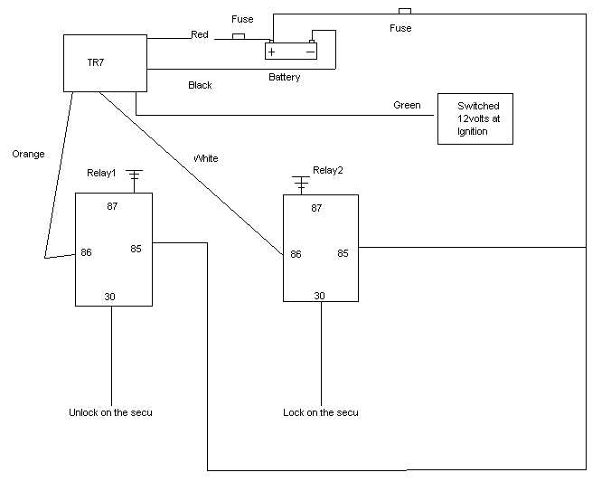

Posted: February 21, 2004 at 11:44 AM / IP Logged
Here is a wiring diagram that I'm using for this please let me know if there is a problem with it.
ThanksProblem with the PAC TR7 -- posted image.
speakerman
Member - Posts: 26
Joined: February 17, 2004
Posted: February 22, 2004 at 12:02 AM / IP Logged
Those things are great for many things but the programming is not fun at all. True ignition means that it read 12 volt in the on position and does not drop lower then like 10 volts when starting the car. I have used like 30 of those things but out of those like 7 were bad and did not work right. You can try redoing it a couple more times and see if it works and make sure you have a good ground on it too. Sorry for the possible bad news but hopefully you can get it to work.

speakerman
Member - Posts: 26
Posted: February 22, 2004 at 5:22 PM / IP Logged
I would call the tech number and ask them what they can do for you. I think that it is the unit not your install but they might be able to tell you a trick that i don't know. good luck with that.
