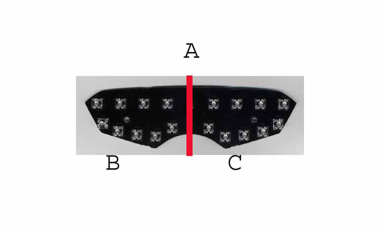

Ok, just let me tell you that this is another one of those Turn signal/Brake light intergration. However, after reading this whole relay forum, I still have not found the write diagram for my project. Let me explain my situation .
I am dealing with an 03 yamaha R6 with led tail lights. Everything is wored up into 1 circuit (only 1 Stop, tail and ground). I am planning on trying to make my own PCB board and convert the single circuit into 2 seprate ones so I could have use one side as turn signals. I have made plenty of DIY boards and projects, but I always used a "HOW-TO" guide.  I know I am capable of doing this. I also know that there is a few retail kits that  replace the whole tailight to intergrate everything. However, I am tired of the how to's and I am ready to learn.
Anyhoo, I keep hearing about using gates. This all confuses me. If that would be the easiest way,  can you guys explain (in noobie language)? On the other hand, if using relays would be better, could you help me get this going? Details below...
My tail light is always on (parking lights) and of course they get bright when I hit the brakes.
What I need is something that would allow one side to blink but allow the parking light to remain on during the whole blink sequence.
Basicly it goes like this...  dim....bright...dim...bright.
However, I would need this sequence when the brake is on also.
Any comments sugestions?

Hi, thanks for the replay! To help explain things, I will show you some pictures of my tail light/
Kind of a complicated circuit..see inside -- posted image.
The Leds are wired with a series of resistors to allow the running light to be dim in a normail stage.  When the brake is applied, it activates another circuit wired with less resistors to  make the leds brighter.
My attempt at the table would be something like this: (I am going to use B as the left turn signal.)
                __________  Parking light  |  Brake light  |  Turn/Flash
running/Parking             |    B/C ON     |   B/C OFF     |        OFF
Left turn                           |     B/C On     |          Off        |      B On
Left Turn while braking  |     B/C ON     |         C on     |      B on
And Vice versa for right hand turns.  Since the running light will always be on I guess the only problem to needs to be worked on is to have the ability to flash the turn signal (bright -dim) while the brake is being applied.

Im still a little confused, are you going to build a new board and new LEDs to make a complete replacement for the entire light assembly? What I get out of this is that the entire light only has 3 settings: off, low and high...?  If you are going to make a new assembly are you going to reuse the LEDs? Is the lens red? if not or if the lens is not that dark of a red it might be possible to add amber leds.... Just trying to fully understand before i say anything..
hbidad
Member - Posts: 6
Joined: February 20, 2004
Posted: February 21, 2004 at 12:21 PM / IP Logged
hi, Yes I am going to redo the PCB and use the same leds. They are really bright. Amber leds? Yeah, I have really been thinking about that also. That kinda sounds a little easier. If you could, help me go that way.
On the board there is 3 solder pads... Ground, tail and stop. what about this...
Take a look at  this. This is what my tail light looks like. This is what I was trying to explain above with the exeption that when the turn signal is on, and instead of going from bright to off, it would go bright to dim.
http://www.flashalert.com/flash/integrator2.swf
sorry for the confussion. I am not very good at explaining things

ohh that animation clears it up.
with a microcontroller that would be easy, with normal logic it will be a little more difficult.
I am assuming the feed wire from the turnsignals that you plan on using are after the flasher and will pulse on and off?
yea if i had that clear lens like that i would put amber and red leds in just for the hell of it, why not go all out.
i think the problem really lies in all the different states, the fact that the brake light flashes will mean you will need another flasher circuit so that without a turnsignal wire it will still operate...
How much electronics experience do you have, you say you have made boards before...?
with a microcontroller based project you are looking at 1 chip, a voltage regulator, some transistors, some resistors and a few caps... with logic it will probably be a good amount more...
