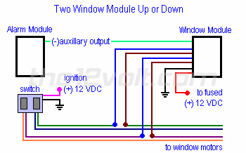

I'd like to install a window roll up module in my 1999 f150 but i'd like it to roll the window down (if this is possible). I want to wire it up to the aux. connection for my keyless entry (auto mate 410) so that when i press the aux button it rolls the windows down. Can someone point me in the direction for directions/wiring diagrams to do this? Thanks

just about any module will work, built-in relays help. just reverse your wiring to make em go down. friend of mine has both 1up and 1 dwn.

I bought one of those omega au-93-4 window roll UP things....it also says it can be used to roll the windows DOWN. but it doesnt show how to on the instruction page they supply.
Can anyone tell me exactly what to wire it up with? Im installing an alarm on it also.
Jlesser said to reverse the wiring....what wires go to which wires?
I just want the windows rolling down...thanks guy!!

Window roll down module in F150 -- posted image.
this should help.....just look up the wiring on your vehicle and pick which wire you want to cut into....either the window up wire...or the window down wire.....you can't simple reverse the wires....youchance frying the switch....

Just find the wire that rolls the window down instead of up.
