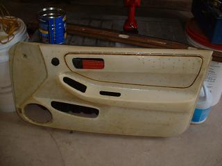

Im currently working on glassing my door panels.  I have one primed and ready...anyways, here's a couple of pics of how i did mine.
Door panels -- posted image.
This is a pic of the raw panel after i removed the vinyl and the foam and cleaned all the glue off of it.

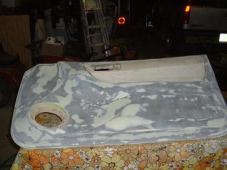

This is a pic of the reconstructed panel almost ready to be primed.

looks nice

looks good did you wrap it in fleese or just lay mat?

First i ruffed up the plastic then put a layer of bondo-glass down, then layed a layer of mat on top of that, then starts the bondo and sanding.
